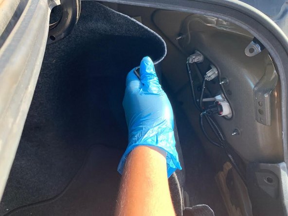

  3. 2013 Toyota Camry Rear Brake Light Bulb Replacement: crwdns2935265:03crwdnd2935265:01crwdnd2935265:02crwdne2935265:0 2013 Toyota Camry Rear Brake Light Bulb Replacement: crwdns2935265:03crwdnd2935265:02crwdnd2935265:02crwdne2935265:0
    • Peel back the canvas on the side where you are replacing the bulb.
    • You will begin to see the cables connected to the rear light.

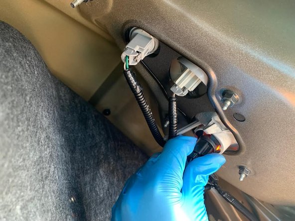

  4. 2013 Toyota Camry Rear Brake Light Bulb Replacement: crwdns2935265:04crwdnd2935265:01crwdnd2935265:01crwdne2935265:0
    • You will see three connections; a brake light, a turn signal light, and a parking light.
    • The one we will be replacing is the brake light bulb, the biggest connection of the three.

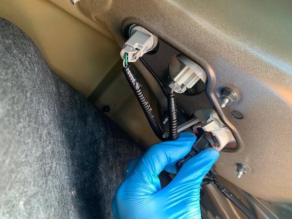

  5. 2013 Toyota Camry Rear Brake Light Bulb Replacement: crwdns2935265:05crwdnd2935265:01crwdnd2935265:02crwdne2935265:0 2013 Toyota Camry Rear Brake Light Bulb Replacement: crwdns2935265:05crwdnd2935265:02crwdnd2935265:02crwdne2935265:0
    • Turn the bulb counterclockwise from the outer connection portion (the black part).
    • Pull the old light bulb from its connection.
    • This may be a bit difficult to pull apart, but not tools are required.

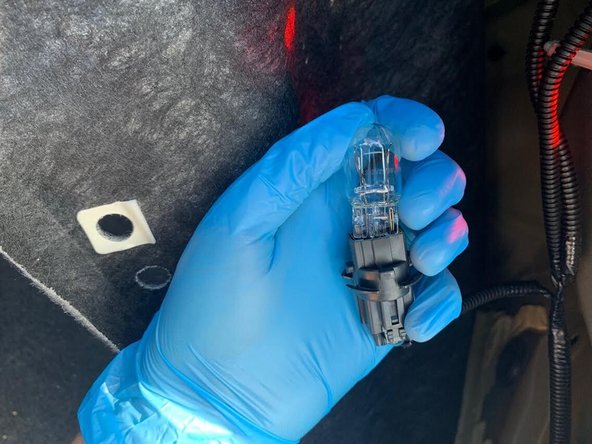

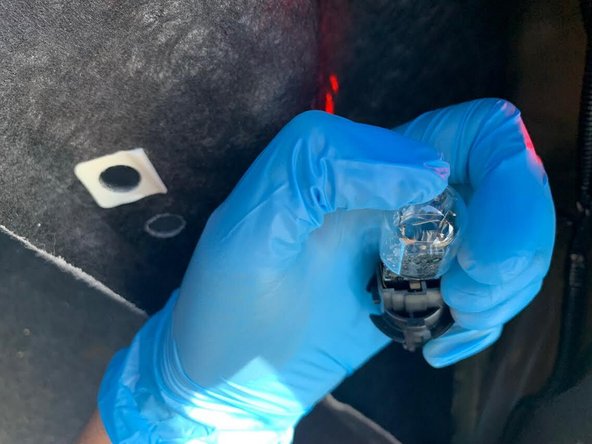

  6. 2013 Toyota Camry Rear Brake Light Bulb Replacement: crwdns2935265:06crwdnd2935265:01crwdnd2935265:03crwdne2935265:0 2013 Toyota Camry Rear Brake Light Bulb Replacement: crwdns2935265:06crwdnd2935265:02crwdnd2935265:03crwdne2935265:0 2013 Toyota Camry Rear Brake Light Bulb Replacement: crwdns2935265:06crwdnd2935265:03crwdnd2935265:03crwdne2935265:0
    • Before handling the new light bulb, wear latex gloves or something to cover your hands. Handling the bulb with bare hands will shorten the light bulb's life span.
    • Plug the new light bulb into the connection by pushing until you hear a click.

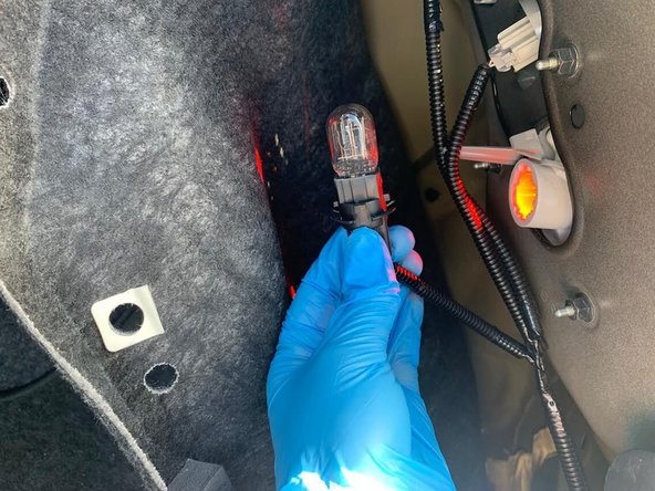

  7. 2013 Toyota Camry Rear Brake Light Bulb Replacement: crwdns2935265:07crwdnd2935265:01crwdnd2935265:03crwdne2935265:0 2013 Toyota Camry Rear Brake Light Bulb Replacement: crwdns2935265:07crwdnd2935265:02crwdnd2935265:03crwdne2935265:0 2013 Toyota Camry Rear Brake Light Bulb Replacement: crwdns2935265:07crwdnd2935265:03crwdnd2935265:03crwdne2935265:0
    • Place the connection into its slot and turn it clockwise to ensure it stays in place.
    • Follow Steps 2 and 3 in reverse.
