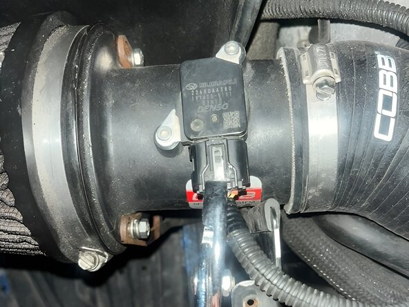

    • Pop, open, and prop the hood.
    • Locate the MAF sensor in the front of the vehicle.
  2. 2013 Subaru Impreza WRX STi MAF Sensor Replacement: crwdns2935265:02crwdnd2935265:01crwdnd2935265:02crwdne2935265:0 2013 Subaru Impreza WRX STi MAF Sensor Replacement: crwdns2935265:02crwdnd2935265:02crwdnd2935265:02crwdne2935265:0
    • Pull the connector straight back to detach it from the MAF sensor.
    • Use pliers if necessary.
  3. 2013 Subaru Impreza WRX STi MAF Sensor Replacement: crwdns2935265:03crwdnd2935265:01crwdnd2935265:01crwdne2935265:0
    • Twist the Allen wrench in a counter-clockwise motion to loosen both 10mm socket-head cap screws.
  4. 2013 Subaru Impreza WRX STi MAF Sensor Replacement: crwdns2935265:04crwdnd2935265:01crwdnd2935265:01crwdne2935265:0
    • Rock the MAF sensor side-to-side. Once loose, firmly pull the sensor out of the socket.
    • Avoid touching the sharp bronze blades inside the sensor.
  5. 2013 Subaru Impreza WRX STi MAF Sensor Replacement: crwdns2935265:05crwdnd2935265:01crwdnd2935265:01crwdne2935265:0
    • Insert the new MAF sensor into the socket. Apply firm, even pressure until the sensor is secure.
    • Line up the screw holes to make the process easier.
  6. 2013 Subaru Impreza WRX STi MAF Sensor Replacement: crwdns2935265:06crwdnd2935265:01crwdnd2935265:01crwdne2935265:0
    • Twist the Allen wrench in a clockwise motion to tighten both 10mm socket-head cap screws.
    • Tightly fasten the screws to prevent the MAF sensor from falling out while the vehicle is in motion.
  7. 2013 Subaru Impreza WRX STi MAF Sensor Replacement: crwdns2935265:07crwdnd2935265:01crwdnd2935265:01crwdne2935265:0
    • Gently push the connector into the new MAF sensor until it clicks into place.
