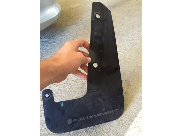

2013 Subaru Impreza WRX Mud Flaps Replacement
  1. 2013 Subaru Impreza WRX Mud Flaps Replacement, Mud Flaps: crwdns2935265:01crwdnd2935265:01crwdnd2935265:01crwdne2935265:0

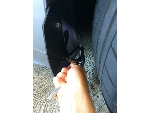

  2. 2013 Subaru Impreza WRX Mud Flaps Replacement: crwdns2935265:02crwdnd2935265:01crwdnd2935265:01crwdne2935265:0
    • Turn the wheels all the way towards the side you will be working on.
    • This will create easier access to the inside of the wheel well when you are replacing the mud flap.

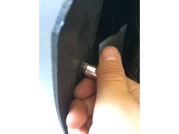

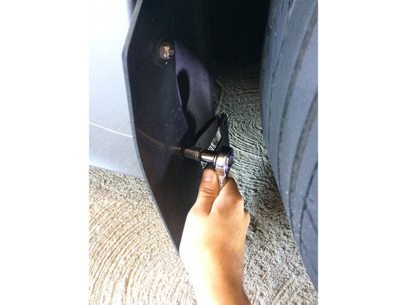

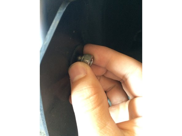

  3. 2013 Subaru Impreza WRX Mud Flaps Replacement: crwdns2935265:03crwdnd2935265:01crwdnd2935265:03crwdne2935265:0 2013 Subaru Impreza WRX Mud Flaps Replacement: crwdns2935265:03crwdnd2935265:02crwdnd2935265:03crwdne2935265:0 2013 Subaru Impreza WRX Mud Flaps Replacement: crwdns2935265:03crwdnd2935265:03crwdnd2935265:03crwdne2935265:0
    • Start with the front mud flaps.
    • Attach the 7/16th size socket piece to the wrench and begin removing the 7/16th diameter nuts.

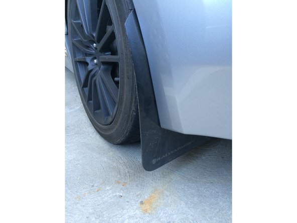

  4. 2013 Subaru Impreza WRX Mud Flaps Replacement: crwdns2935265:04crwdnd2935265:01crwdnd2935265:03crwdne2935265:0 2013 Subaru Impreza WRX Mud Flaps Replacement: crwdns2935265:04crwdnd2935265:02crwdnd2935265:03crwdne2935265:0 2013 Subaru Impreza WRX Mud Flaps Replacement: crwdns2935265:04crwdnd2935265:03crwdnd2935265:03crwdne2935265:0
    • Use your Philips Head screwdriver to unscrew the farthest #6 3/4" Stainless Philips Screw.
    • Be careful not to loose the rubber gasket attached to the screw.

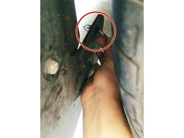

  5. 2013 Subaru Impreza WRX Mud Flaps Replacement: crwdns2935265:05crwdnd2935265:01crwdnd2935265:03crwdne2935265:0 2013 Subaru Impreza WRX Mud Flaps Replacement: crwdns2935265:05crwdnd2935265:02crwdnd2935265:03crwdne2935265:0 2013 Subaru Impreza WRX Mud Flaps Replacement: crwdns2935265:05crwdnd2935265:03crwdnd2935265:03crwdne2935265:0
    • Once the old mud flap is removed, grab your new mud flap and reattach it in the same manner as how you removed the old or broken one.
    • Repeat for opposite front mud flap.

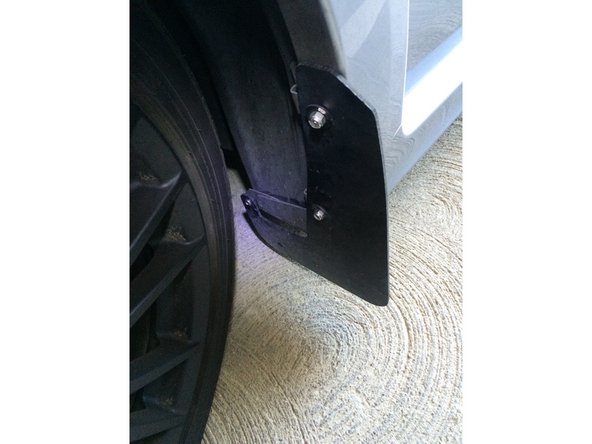

  6. 2013 Subaru Impreza WRX Mud Flaps Replacement: crwdns2935265:06crwdnd2935265:01crwdnd2935265:03crwdne2935265:0 2013 Subaru Impreza WRX Mud Flaps Replacement: crwdns2935265:06crwdnd2935265:02crwdnd2935265:03crwdne2935265:0 2013 Subaru Impreza WRX Mud Flaps Replacement: crwdns2935265:06crwdnd2935265:03crwdnd2935265:03crwdne2935265:0
    • For the back two mud flaps you will need to use a slightly different technique due to the limited space you will be working in.
    • Use your hands and the 10mm wrench piece to unbolt the mud flap.
    • Once you have removed the nuts, you can move on to the #6 3/4" Philips Head Screw.
    • This step will be aided by the use of an extra small Philips screwdriver.
