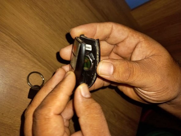

    • Remove the key from the keyring by pulling the button on the back of the keyring from right to left while pulling the loop at the top.
  2. 2013 Nissan Rogue Key Fob Battery Replacement: crwdns2935265:02crwdnd2935265:01crwdnd2935265:03crwdne2935265:0 2013 Nissan Rogue Key Fob Battery Replacement: crwdns2935265:02crwdnd2935265:02crwdnd2935265:03crwdne2935265:0 2013 Nissan Rogue Key Fob Battery Replacement: crwdns2935265:02crwdnd2935265:03crwdnd2935265:03crwdne2935265:0
    • Carefully separate the back cover from the rest of the remote.
    • You can use a tool to make this step easier, or you can just do it using your fingers, being very careful.
  3. 2013 Nissan Rogue Key Fob Battery Replacement: crwdns2935265:03crwdnd2935265:01crwdnd2935265:02crwdne2935265:0 2013 Nissan Rogue Key Fob Battery Replacement: crwdns2935265:03crwdnd2935265:02crwdnd2935265:02crwdne2935265:0
    • Carefully remove the individual pieces from inside, one at a time.
    • There are two pieces in total to remove.
  4. 2013 Nissan Rogue Key Fob Battery Replacement: crwdns2935265:04crwdnd2935265:01crwdnd2935265:01crwdne2935265:0
    • Remove the battery from the remote.
    • Put the new battery into the remote and press down firmly to make sure it is secure.
    • Be sure to check that your new battery matches with your old battery.
  5. 2013 Nissan Rogue Key Fob Battery Replacement: crwdns2935265:05crwdnd2935265:01crwdnd2935265:02crwdne2935265:0 2013 Nissan Rogue Key Fob Battery Replacement: crwdns2935265:05crwdnd2935265:02crwdnd2935265:02crwdne2935265:0
    • Carefully snap the back cover onto the rest of the remote.
  6. 2013 Nissan Rogue Key Fob Battery Replacement: crwdns2935265:06crwdnd2935265:01crwdnd2935265:02crwdne2935265:0 2013 Nissan Rogue Key Fob Battery Replacement: crwdns2935265:06crwdnd2935265:02crwdnd2935265:02crwdne2935265:0
    • Put the key back into the remote.
  7. 2013 Nissan Rogue Key Fob Battery Replacement: crwdns2935265:07crwdnd2935265:01crwdnd2935265:01crwdne2935265:0
    • Test the remote key to make sure it works properly.
