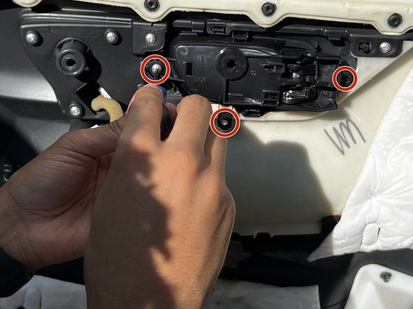

  5. 2013 Nissan Altima Interior Door Handle Replacement: crwdns2935265:05crwdnd2935265:01crwdnd2935265:01crwdne2935265:0
    • Unscrew the three silver screws directly behind the door handle (Top, left, right).
