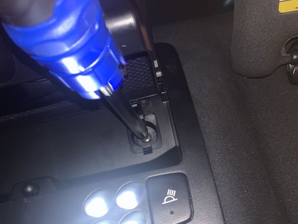

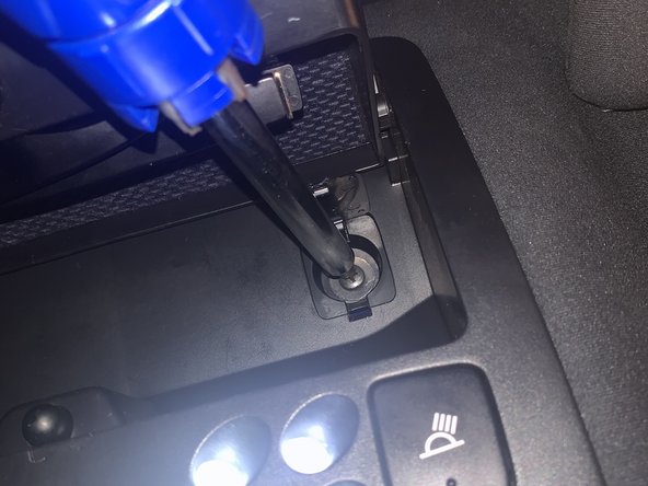

    • Utilize a star screwdriver to remove the screws holding the front dome light in place. Ensure a steady hand to prevent any accidental dropping of screws.

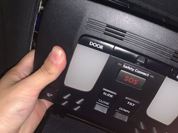

  4. 2013 Lexus IS250 Front Dome Light Replacement: crwdns2935265:04crwdnd2935265:01crwdnd2935265:03crwdne2935265:0 2013 Lexus IS250 Front Dome Light Replacement: crwdns2935265:04crwdnd2935265:02crwdnd2935265:03crwdne2935265:0 2013 Lexus IS250 Front Dome Light Replacement: crwdns2935265:04crwdnd2935265:03crwdnd2935265:03crwdne2935265:0
    • With both hands wiggle both sides of the dome. Apply a bit of force at the top to release it from its position. Be cautious to not break the plastic clips securing it.

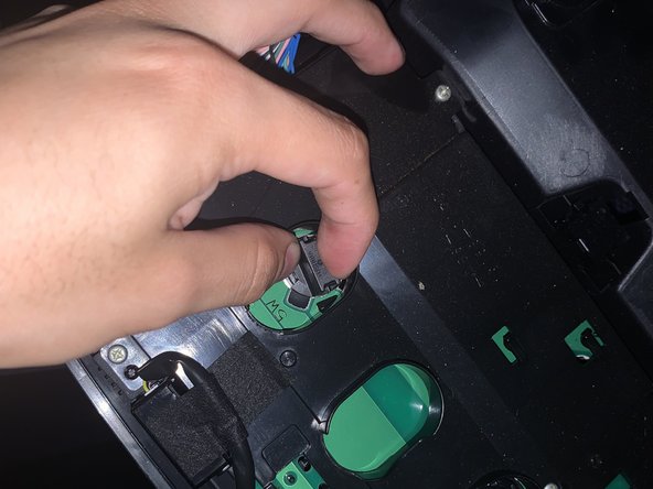

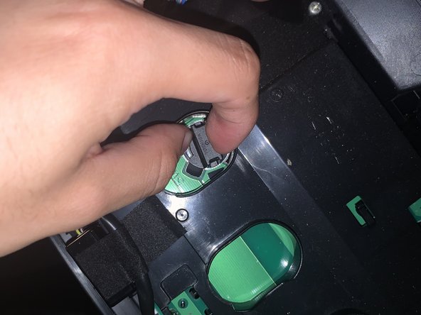

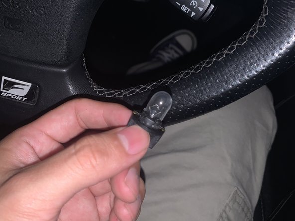

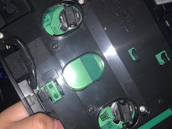

  5. 2013 Lexus IS250 Front Dome Light Replacement: crwdns2935265:05crwdnd2935265:01crwdnd2935265:03crwdne2935265:0 2013 Lexus IS250 Front Dome Light Replacement: crwdns2935265:05crwdnd2935265:02crwdnd2935265:03crwdne2935265:0 2013 Lexus IS250 Front Dome Light Replacement: crwdns2935265:05crwdnd2935265:03crwdnd2935265:03crwdne2935265:0

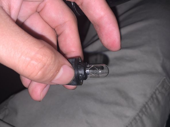

    • Inside, youll find two bulbs on both ends. Twist them to unlock and carefully remove.

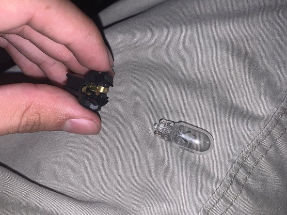

  6. 2013 Lexus IS250 Front Dome Light Replacement: crwdns2935265:06crwdnd2935265:01crwdnd2935265:02crwdne2935265:0 2013 Lexus IS250 Front Dome Light Replacement: crwdns2935265:06crwdnd2935265:02crwdnd2935265:02crwdne2935265:0
    • Carefully remove bulb. Recommended to use gloves as it can be difficult to get a grip.
  7. 2013 Lexus IS250 Front Dome Light Replacement: crwdns2935265:07crwdnd2935265:01crwdnd2935265:03crwdne2935265:0 2013 Lexus IS250 Front Dome Light Replacement: crwdns2935265:07crwdnd2935265:02crwdnd2935265:03crwdne2935265:0 2013 Lexus IS250 Front Dome Light Replacement: crwdns2935265:07crwdnd2935265:03crwdnd2935265:03crwdne2935265:0
    • Replace these bulbs with LED alternatives, inserting them and securing by twisting.
