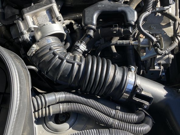

    • Pull the hood latch located inside the car under your remote holder.
    • Outside the car, find the lever under the actual hood, and squeeze and lift the hood.

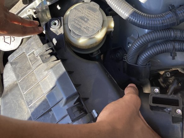

    • Unscrew the mass airflow filter box from the frame with a Phillips #1 screwdriver.
  2. 2013 Infiniti G37 Dual Air Intakes Replacement: crwdns2935265:02crwdnd2935265:01crwdnd2935265:03crwdne2935265:0 2013 Infiniti G37 Dual Air Intakes Replacement: crwdns2935265:02crwdnd2935265:02crwdnd2935265:03crwdne2935265:0 2013 Infiniti G37 Dual Air Intakes Replacement: crwdns2935265:02crwdnd2935265:03crwdnd2935265:03crwdne2935265:0

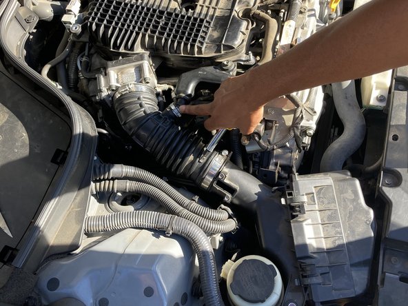

    • Loosen the five bolts in the engine cover so you can have more space to access the mass airflow tubes.
  3. 2013 Infiniti G37 Dual Air Intakes Replacement: crwdns2935265:03crwdnd2935265:01crwdnd2935265:03crwdne2935265:0 2013 Infiniti G37 Dual Air Intakes Replacement: crwdns2935265:03crwdnd2935265:02crwdnd2935265:03crwdne2935265:0 2013 Infiniti G37 Dual Air Intakes Replacement: crwdns2935265:03crwdnd2935265:03crwdnd2935265:03crwdne2935265:0

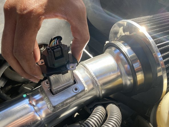

    • Loosen the mass airflow sensor from the airflow tube and safely move it to a safe location out of the way.

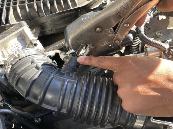

    • Use vice grips to remove the clamp.
  4. 2013 Infiniti G37 Dual Air Intakes Replacement: crwdns2935265:04crwdnd2935265:01crwdnd2935265:03crwdne2935265:0 2013 Infiniti G37 Dual Air Intakes Replacement: crwdns2935265:04crwdnd2935265:02crwdnd2935265:03crwdne2935265:0 2013 Infiniti G37 Dual Air Intakes Replacement: crwdns2935265:04crwdnd2935265:03crwdnd2935265:03crwdne2935265:0
    • Loosen the last clamp, located at the head of the airflow tube, and give a firm tug towards you to free the entire piece.
  5. 2013 Infiniti G37 Dual Air Intakes Replacement: crwdns2935265:05crwdnd2935265:01crwdnd2935265:03crwdne2935265:0 2013 Infiniti G37 Dual Air Intakes Replacement: crwdns2935265:05crwdnd2935265:02crwdnd2935265:03crwdne2935265:0 2013 Infiniti G37 Dual Air Intakes Replacement: crwdns2935265:05crwdnd2935265:03crwdnd2935265:03crwdne2935265:0

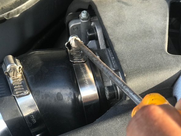

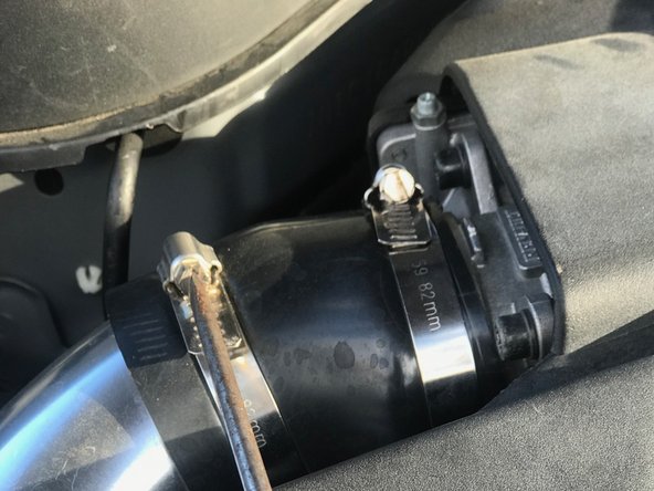

    • Connect the mass airflow tube and tighten the clamps with a flathead screwdriver.
  6. 2013 Infiniti G37 Dual Air Intakes Replacement: crwdns2935265:06crwdnd2935265:01crwdnd2935265:03crwdne2935265:0 2013 Infiniti G37 Dual Air Intakes Replacement: crwdns2935265:06crwdnd2935265:02crwdnd2935265:03crwdne2935265:0 2013 Infiniti G37 Dual Air Intakes Replacement: crwdns2935265:06crwdnd2935265:03crwdnd2935265:03crwdne2935265:0
    • After all the clamps are tightened, place the mass airflow sensor into the tube and tighten with a Phillips #1 screwdriver.
