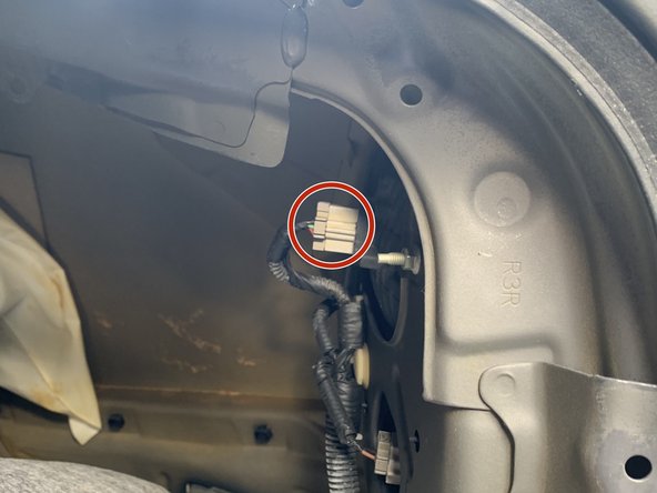

  3. 2013 Honda Civic Brake Light Replacement: crwdns2935265:03crwdnd2935265:01crwdnd2935265:02crwdne2935265:0 2013 Honda Civic Brake Light Replacement: crwdns2935265:03crwdnd2935265:02crwdnd2935265:02crwdne2935265:0
    • Pull back the carpet liner from the walls of the trunk.
    • Locate the housing compartment for the brake light socket.
  4. 2013 Honda Civic Brake Light Replacement: crwdns2935265:04crwdnd2935265:01crwdnd2935265:02crwdne2935265:0 2013 Honda Civic Brake Light Replacement: crwdns2935265:04crwdnd2935265:02crwdnd2935265:02crwdne2935265:0
    • Remove the brake light socket from the housing compartment by turning it ¼ of a turn counterclockwise to unlock.
    • Pull the brake light socket from the housing compartment.

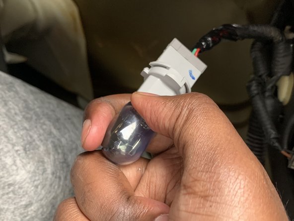

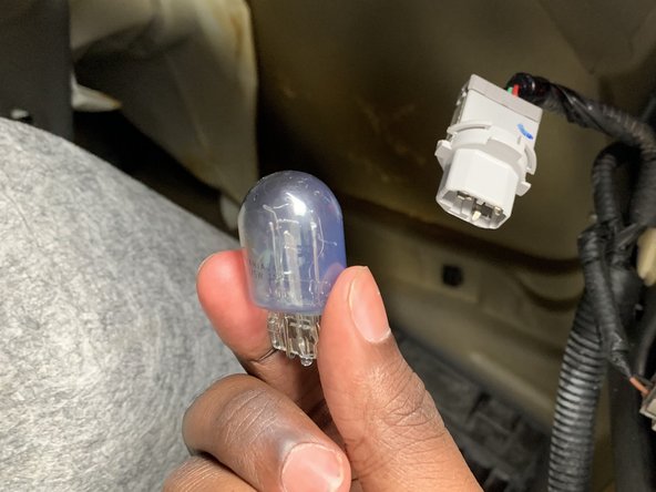

  5. 2013 Honda Civic Brake Light Replacement: crwdns2935265:05crwdnd2935265:01crwdnd2935265:03crwdne2935265:0 2013 Honda Civic Brake Light Replacement: crwdns2935265:05crwdnd2935265:02crwdnd2935265:03crwdne2935265:0 2013 Honda Civic Brake Light Replacement: crwdns2935265:05crwdnd2935265:03crwdnd2935265:03crwdne2935265:0
    • Remove the burned-out light bulb from the brake light socket.

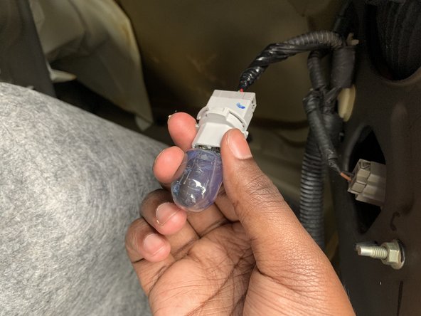

  6. 2013 Honda Civic Brake Light Replacement: crwdns2935265:06crwdnd2935265:01crwdnd2935265:02crwdne2935265:0 2013 Honda Civic Brake Light Replacement: crwdns2935265:06crwdnd2935265:02crwdnd2935265:02crwdne2935265:0
    • Insert the new brake light bulb into the brake light socket.
  7. 2013 Honda Civic Brake Light Replacement: crwdns2935265:07crwdnd2935265:01crwdnd2935265:02crwdne2935265:0 2013 Honda Civic Brake Light Replacement: crwdns2935265:07crwdnd2935265:02crwdnd2935265:02crwdne2935265:0
    • Insert the brake light socket back into the housing compartment by turning it ¼ of a turn clockwise to lock.
