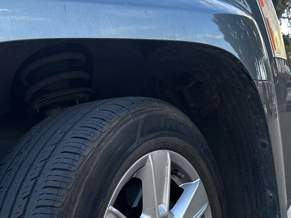

    • Identify which headlight is out.
  2. 2013 GMC Terrain Headlight Bulb Replacement: crwdns2935265:02crwdnd2935265:01crwdnd2935265:03crwdne2935265:0 2013 GMC Terrain Headlight Bulb Replacement: crwdns2935265:02crwdnd2935265:02crwdnd2935265:03crwdne2935265:0 2013 GMC Terrain Headlight Bulb Replacement: crwdns2935265:02crwdnd2935265:03crwdnd2935265:03crwdne2935265:0

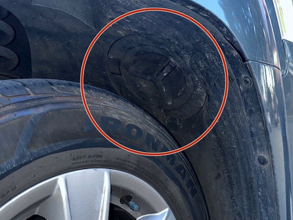

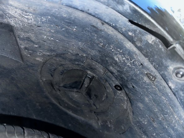

    • Turn the wheels toward the opposite side of the broken headlight.
    • Go to the Front fender, which is on the same side as the broken headlight, to find the cover in the inner fender.

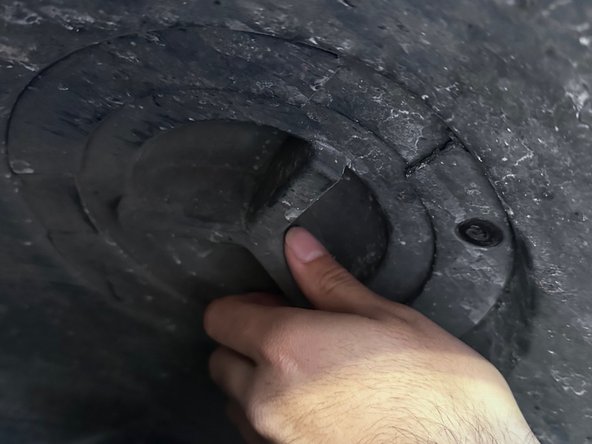

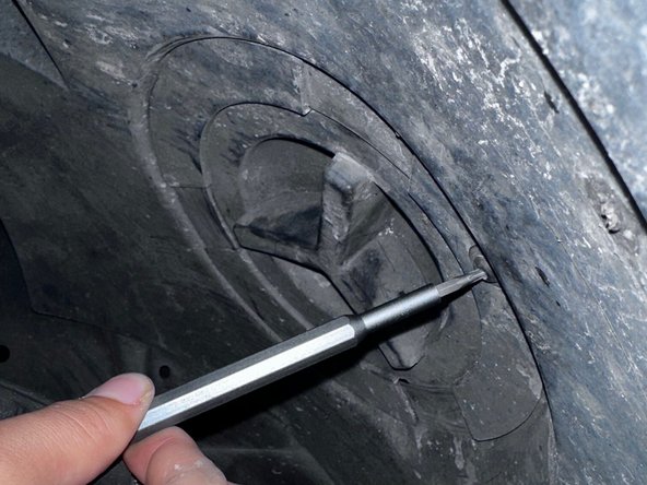

  3. 2013 GMC Terrain Headlight Bulb Replacement: crwdns2935265:03crwdnd2935265:01crwdnd2935265:03crwdne2935265:0 2013 GMC Terrain Headlight Bulb Replacement: crwdns2935265:03crwdnd2935265:02crwdnd2935265:03crwdne2935265:0 2013 GMC Terrain Headlight Bulb Replacement: crwdns2935265:03crwdnd2935265:03crwdnd2935265:03crwdne2935265:0
    • Use a T15 Torx screwdriver to remove the screw.
    • Turn the cover counterclockwise to remove it.

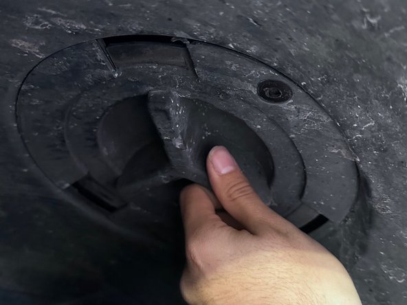

  4. 2013 GMC Terrain Headlight Bulb Replacement: crwdns2935265:04crwdnd2935265:01crwdnd2935265:03crwdne2935265:0 2013 GMC Terrain Headlight Bulb Replacement: crwdns2935265:04crwdnd2935265:02crwdnd2935265:03crwdne2935265:0 2013 GMC Terrain Headlight Bulb Replacement: crwdns2935265:04crwdnd2935265:03crwdnd2935265:03crwdne2935265:0

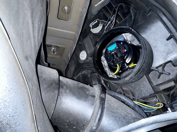

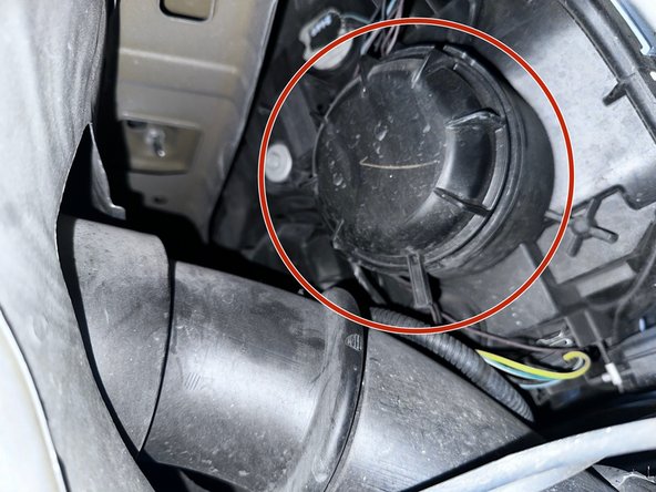

    • Reach your hand into the hole to find the round cap to the bulb.
    • Turn it counterclockwise to expose the socket holding the bulb.

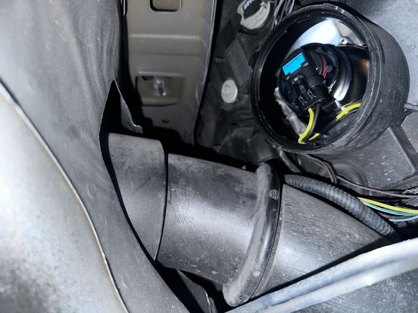

  5. 2013 GMC Terrain Headlight Bulb Replacement: crwdns2935265:05crwdnd2935265:01crwdnd2935265:02crwdne2935265:0 2013 GMC Terrain Headlight Bulb Replacement: crwdns2935265:05crwdnd2935265:02crwdnd2935265:02crwdne2935265:0

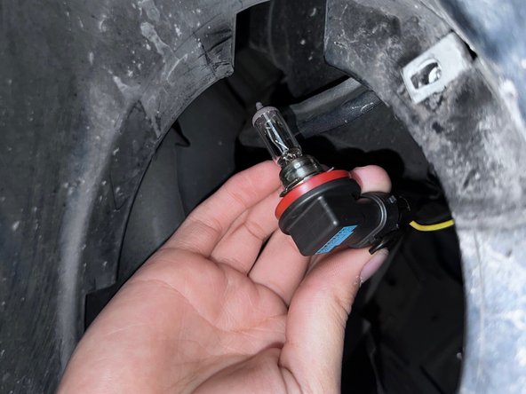

    • Twist the socket counterclockwise and pull it out to expose the bulb.
  6. 2013 GMC Terrain Headlight Bulb Replacement: crwdns2935265:06crwdnd2935265:01crwdnd2935265:02crwdne2935265:0 2013 GMC Terrain Headlight Bulb Replacement: crwdns2935265:06crwdnd2935265:02crwdnd2935265:02crwdne2935265:0

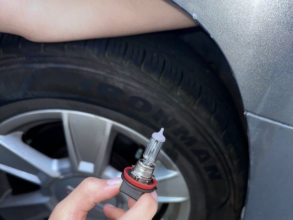

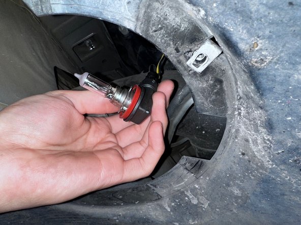

    • Unclip the old bulb from the socket.
  7. 2013 GMC Terrain Headlight Bulb Replacement: crwdns2935265:07crwdnd2935265:01crwdnd2935265:03crwdne2935265:0 2013 GMC Terrain Headlight Bulb Replacement: crwdns2935265:07crwdnd2935265:02crwdnd2935265:03crwdne2935265:0 2013 GMC Terrain Headlight Bulb Replacement: crwdns2935265:07crwdnd2935265:03crwdnd2935265:03crwdne2935265:0
    • Grab your new bulb.
    • Make sure not to touch the actual bulb because the oils from your skin can cause it to burn out.
    • Plug it back into the socket and twist it clockwise in the hole.
