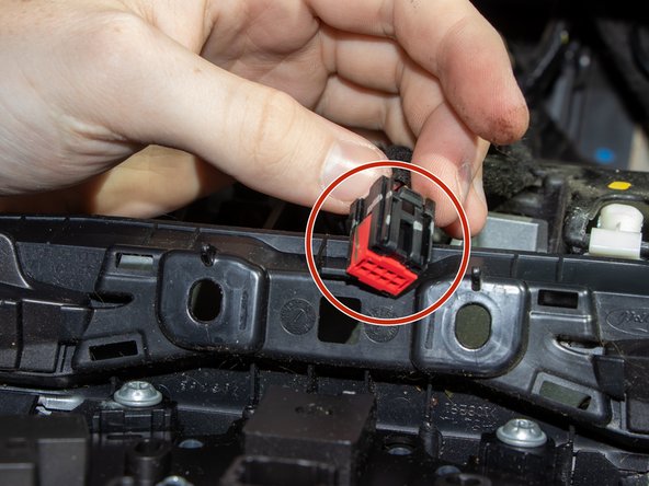

    • Carefully lift the panel up and out.
    • There is a wire attached to the back of panel.
    • Unplug the stereo connector from the panel and set aside the panel.

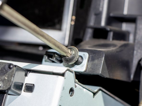

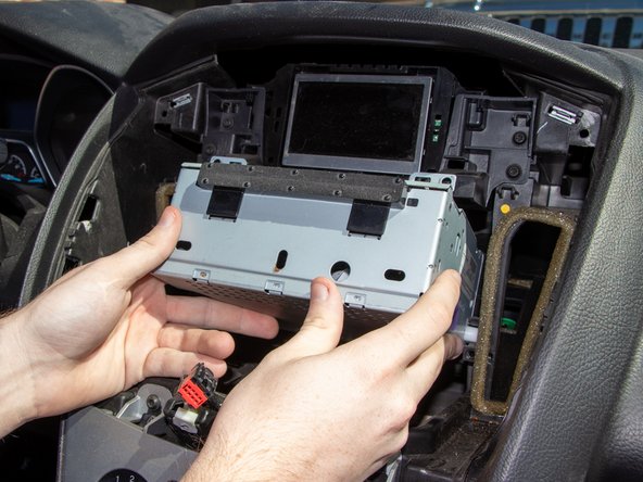

    • There are two Torx screw's attached to the stereo box.
  4. 2013 Ford Focus SE  Stereo Replacement: crwdns2935265:04crwdnd2935265:01crwdnd2935265:03crwdne2935265:0 2013 Ford Focus SE  Stereo Replacement: crwdns2935265:04crwdnd2935265:02crwdnd2935265:03crwdne2935265:0 2013 Ford Focus SE  Stereo Replacement: crwdns2935265:04crwdnd2935265:03crwdnd2935265:03crwdne2935265:0
    • Use the Torx T20 screwdriver to unscrew the top left and top right 19 mm screws.
    • Slowly remove the stereo box from the screw connectors.

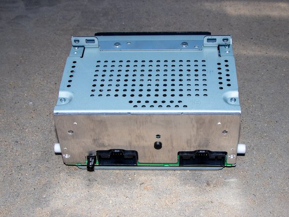

  5. 2013 Ford Focus SE  Stereo Replacement: crwdns2935265:05crwdnd2935265:01crwdnd2935265:03crwdne2935265:0 2013 Ford Focus SE  Stereo Replacement: crwdns2935265:05crwdnd2935265:02crwdnd2935265:03crwdne2935265:0 2013 Ford Focus SE  Stereo Replacement: crwdns2935265:05crwdnd2935265:03crwdnd2935265:03crwdne2935265:0
    • Once the stereo box is removed from connectors, there will be 3 cords attached to the box.
    • The yellow wire will require some force to open because it serves as the power connector for the stereo.
    • Carefully push down on the clamp to disconnect the yellow wire on the far left of the box.
    • Push down on the clamps in the middle to remove the middle wire.
    • Push down on the clamps in the middle to remove the far right wire.

    • Once the wires are disconnected, safely remove the stereo box.
    • In order to proceed to the next step, reassemble the new stereo by following the steps in reverse order.
