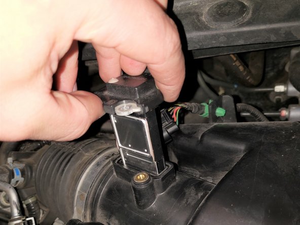

2013 Acura ILX Mass Air Flow Sensor Replacement
  1. 2013 Acura ILX Mass Air Flow Sensor Replacement, Mass Air Flow Sensor: crwdns2935265:01crwdnd2935265:01crwdnd2935265:01crwdne2935265:0
    • Disconnect the battery terminals by first loosening them with a 10 mm wrench.
    • Always remove the negative terminal first to prevent shorting to ground and possibly causing shock or even a fire.
    • Make sure the car is off and the the key is out of the ignition.
  2. 2013 Acura ILX Mass Air Flow Sensor Replacement: crwdns2935265:02crwdnd2935265:01crwdnd2935265:01crwdne2935265:0
    • Squeeze the clip on the top side of the wiring connector and pull out to remove it.
    • Do not touch the connections with your fingers, it may bend the needles and cause malfunction.
  3. 2013 Acura ILX Mass Air Flow Sensor Replacement: crwdns2935265:03crwdnd2935265:01crwdnd2935265:02crwdne2935265:0 2013 Acura ILX Mass Air Flow Sensor Replacement: crwdns2935265:03crwdnd2935265:02crwdnd2935265:02crwdne2935265:0
    • With a Phillips screwdriver, unscrew the two bolts that hold the sensor in place.
    • Pull the sensor up slowly to take it out of its casing
  4. 2013 Acura ILX Mass Air Flow Sensor Replacement: crwdns2935265:04crwdnd2935265:01crwdnd2935265:01crwdne2935265:0
    • With a cloth towel, clean the surface from any dirt or oil.
    • Try not to have anything fall into the opening where the sensor is positioned.
  5. 2013 Acura ILX Mass Air Flow Sensor Replacement: crwdns2935265:05crwdnd2935265:01crwdnd2935265:01crwdne2935265:0
    • Insert the new sensor and secure it down using the Philips screwdriver.
  6. 2013 Acura ILX Mass Air Flow Sensor Replacement: crwdns2935265:06crwdnd2935265:01crwdnd2935265:02crwdne2935265:0 2013 Acura ILX Mass Air Flow Sensor Replacement: crwdns2935265:06crwdnd2935265:02crwdnd2935265:02crwdne2935265:0
    • Connect the wiring harness back on the sensor.
Your car is fixed! The new sensor will improve the performance of the vehicle.
