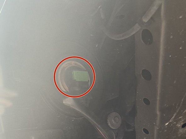

  5. 2013-2015 Nissan Altima Low Beam Bulb Replacement: crwdns2935265:05crwdnd2935265:01crwdnd2935265:03crwdne2935265:0 2013-2015 Nissan Altima Low Beam Bulb Replacement: crwdns2935265:05crwdnd2935265:02crwdnd2935265:03crwdne2935265:0 2013-2015 Nissan Altima Low Beam Bulb Replacement: crwdns2935265:05crwdnd2935265:03crwdnd2935265:03crwdne2935265:0
    • Turn the lightbulb holder counter clockwise until it is released from the headlight
  6. 2013-2015 Nissan Altima Low Beam Bulb Replacement: crwdns2935265:06crwdnd2935265:01crwdnd2935265:02crwdne2935265:0 2013-2015 Nissan Altima Low Beam Bulb Replacement: crwdns2935265:06crwdnd2935265:02crwdnd2935265:02crwdne2935265:0
    • Pull up on the tab on the back of the bulb holder and simultaneously pull the light bulb out.
  7. 2013-2015 Nissan Altima Low Beam Bulb Replacement: crwdns2935265:07crwdnd2935265:01crwdnd2935265:03crwdne2935265:0 2013-2015 Nissan Altima Low Beam Bulb Replacement: crwdns2935265:07crwdnd2935265:02crwdnd2935265:03crwdne2935265:0 2013-2015 Nissan Altima Low Beam Bulb Replacement: crwdns2935265:07crwdnd2935265:03crwdnd2935265:03crwdne2935265:0
    • Replace the lightbulb by putting the new in place of the old one that was just removed.
    • Remember to insert the new light you must once again lift the tab while simultaneously inserting the new light bulb.
