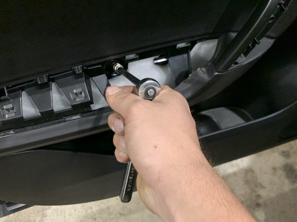

    • Remove the T20 Torx bolt underneath the door trim pull piece.

  8. 2012 Volkswagen Touareg Door Lock Switch Replacement: crwdns2935265:08crwdnd2935265:01crwdnd2935265:01crwdne2935265:0
    • Remove the T20 Torx bolt at the very bottom of the door panel.
