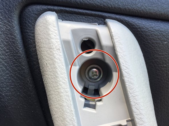

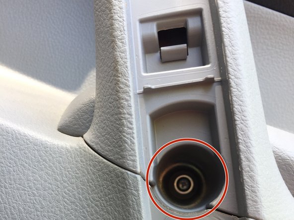

  2. 2012 Toyota Highlander Door Lock Actuator Motor Replacement, Door handle fastener: crwdns2935265:02crwdnd2935265:01crwdnd2935265:02crwdne2935265:0 2012 Toyota Highlander Door Lock Actuator Motor Replacement, Door handle fastener: crwdns2935265:02crwdnd2935265:02crwdnd2935265:02crwdne2935265:0
    • Remove the black plastic cover "plate" behind the door handle. I pulled open the door handle and used a metal spudger in the lower right corner to pop out this cover plate.

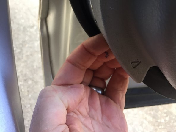

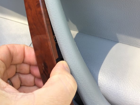

  3. 2012 Toyota Highlander Door Lock Actuator Motor Replacement, Remove Door Pull Trim: crwdns2935265:03crwdnd2935265:01crwdnd2935265:03crwdne2935265:0 2012 Toyota Highlander Door Lock Actuator Motor Replacement, Remove Door Pull Trim: crwdns2935265:03crwdnd2935265:02crwdnd2935265:03crwdne2935265:0 2012 Toyota Highlander Door Lock Actuator Motor Replacement, Remove Door Pull Trim: crwdns2935265:03crwdnd2935265:03crwdnd2935265:03crwdne2935265:0
    • Grip the brown plastic trim at the bottom and carefully pull outward. I have small fingers and prefer slipping them into the crevices to pop the trim at the edges. It might not be the safest option but it gives me precise control.
    • If you prefer to use a plastic or metal spudger or another type of plastic auto trim removal tool you could carefully slip that tool in the crevice and pop the trim.
  4. 2012 Toyota Highlander Door Lock Actuator Motor Replacement, Remove fasteners: crwdns2935265:04crwdnd2935265:01crwdnd2935265:03crwdne2935265:0 2012 Toyota Highlander Door Lock Actuator Motor Replacement, Remove fasteners: crwdns2935265:04crwdnd2935265:02crwdnd2935265:03crwdne2935265:0 2012 Toyota Highlander Door Lock Actuator Motor Replacement, Remove fasteners: crwdns2935265:04crwdnd2935265:03crwdnd2935265:03crwdne2935265:0
    • Remove the 3 Phillips head screws from the door handle (1) and from the door pull (2).
    • The two door pull screws are in a somewhat deep cylinder so you'll need a few inches and a slim enough screwdriver to reach.
    • Also, for some reason the door pull screws wanted to stick in the cylinder after I backed them all of the way out...in that case I used long nose or tweezers to pull the screws out.

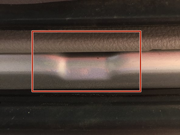

    • Locate an area to start pulling the panel away from the frame (I chose the lower right corner. I wedged my fingers inside the panel and pulled outward - this will take a bit of force to pop the first couple of fasteners.
    • At the very bottom of the door I noticed a recessed spot (see picture) that could be a useful starting point for a panel removal tool.

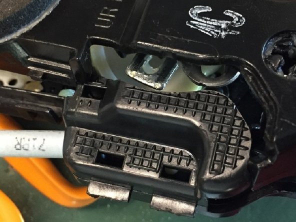

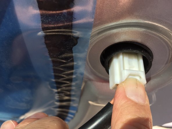

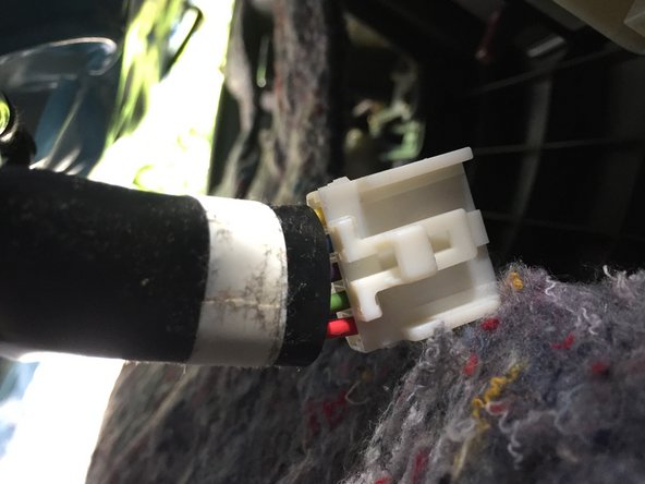

  6. 2012 Toyota Highlander Door Lock Actuator Motor Replacement, Remove Door Panel Electrical Connector: crwdns2935265:06crwdnd2935265:01crwdnd2935265:03crwdne2935265:0 2012 Toyota Highlander Door Lock Actuator Motor Replacement, Remove Door Panel Electrical Connector: crwdns2935265:06crwdnd2935265:02crwdnd2935265:03crwdne2935265:0 2012 Toyota Highlander Door Lock Actuator Motor Replacement, Remove Door Panel Electrical Connector: crwdns2935265:06crwdnd2935265:03crwdnd2935265:03crwdne2935265:0
    • There is one electrical connector for the door light that need to be removed in the panel. From the bottom of the door, with the panel opened up, I pressed in on the tab in the middle of the harness connector will release the harness and simultaneously then we need to pull the harness down, away and out of the mating connector

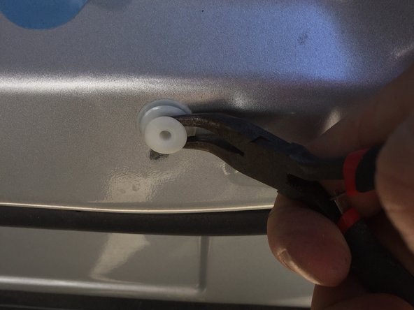

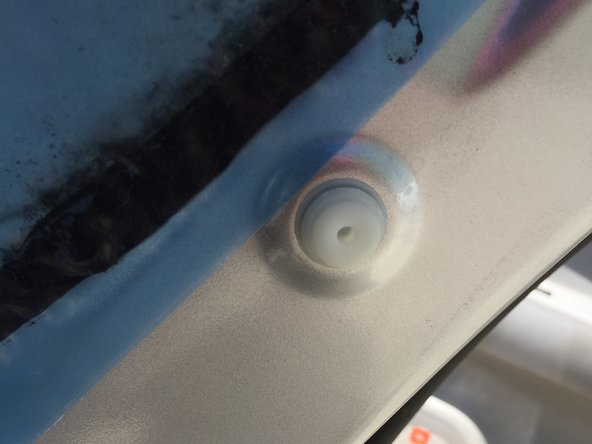

    • Upon inspecting the inside of the door I noticed two plastic panel fasteners that stayed in the door. I removed these with small bent needle nose pliers and placed them back in the door panel. I have removed all of the door panels on the Highlander to do this repair but this is the first time the clips came out of the panel!

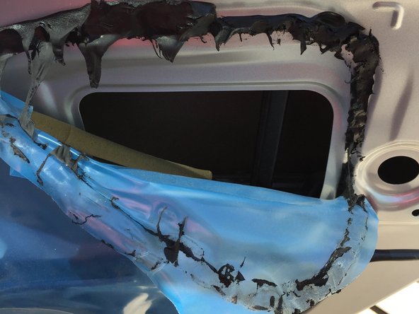

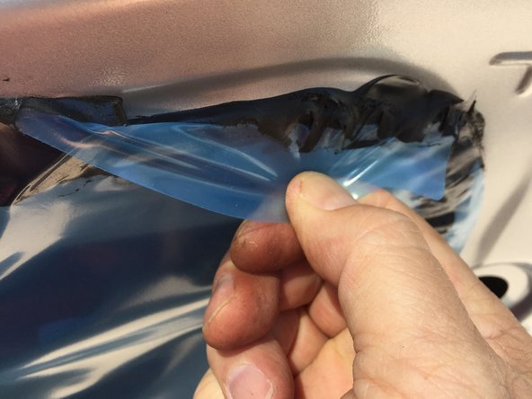

  10. 2012 Toyota Highlander Door Lock Actuator Motor Replacement, Prepare actuator for removal: crwdns2935265:010crwdnd2935265:01crwdnd2935265:03crwdne2935265:0 2012 Toyota Highlander Door Lock Actuator Motor Replacement, Prepare actuator for removal: crwdns2935265:010crwdnd2935265:02crwdnd2935265:03crwdne2935265:0 2012 Toyota Highlander Door Lock Actuator Motor Replacement, Prepare actuator for removal: crwdns2935265:010crwdnd2935265:03crwdnd2935265:03crwdne2935265:0
    • Carefully pull the right side corner of the blue plastic covering the large rectangular opening in the door frame.
    • The actuator is located in the large cavity on the upper right part of the door frame. This is where the two cables are emerging from the blue plastic covering.

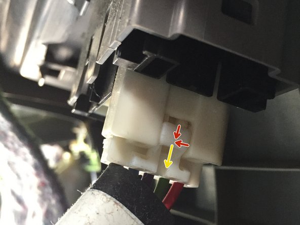

  11. 2012 Toyota Highlander Door Lock Actuator Motor Replacement, Prepare for door lock actuator removal: crwdns2935265:011crwdnd2935265:01crwdnd2935265:02crwdne2935265:0 2012 Toyota Highlander Door Lock Actuator Motor Replacement, Prepare for door lock actuator removal: crwdns2935265:011crwdnd2935265:02crwdnd2935265:02crwdne2935265:0
    • Remove the door lock actuator wiring harness by pressing the harness tab and simultaneously pulling it back and out of the connector housing.

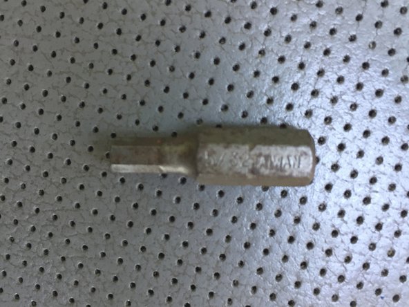

  12. 2012 Toyota Highlander Door Lock Actuator Motor Replacement, Unbolt Door Lock Actuator: crwdns2935265:012crwdnd2935265:01crwdnd2935265:02crwdne2935265:0 2012 Toyota Highlander Door Lock Actuator Motor Replacement, Unbolt Door Lock Actuator: crwdns2935265:012crwdnd2935265:02crwdnd2935265:02crwdne2935265:0
    • The three bolts to remove are Torx type and I think they are T20. My pitiful old bit set was missing or never came with the necessary T-20 bit.
    • Although I wouldn't recommend this, being a little lazy, I decided to use a 5/32 " hex bit which was obviously imperfect but a nonetheless tight fit without slipping and it easily removed the bolts without any stripping.

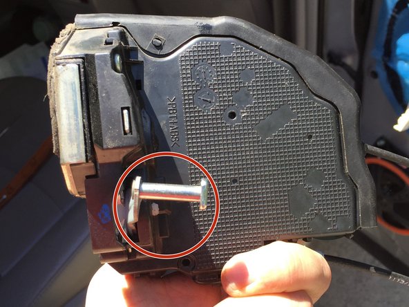

  13. 2012 Toyota Highlander Door Lock Actuator Motor Replacement, Remove Door Lock Actuator: crwdns2935265:013crwdnd2935265:01crwdnd2935265:02crwdne2935265:0 2012 Toyota Highlander Door Lock Actuator Motor Replacement, Remove Door Lock Actuator: crwdns2935265:013crwdnd2935265:02crwdnd2935265:02crwdne2935265:0
    • With the actuator unbolted reach inside the opening in the door frame and grasp the actuator assembly.
    • This rear passenger door uses a plastic fork extension for the outside handle instead of the metal rod type in the other doors. The back side of the door lock actuator has a short horizontal bar that gets engaged by the outside handle fork extension.
    • Inside of the opening there is a vertical metal strip interfering with the easy removal of the actuator. Therefore, some maneuvering of the door lock actuator is required for the metal bar on the back of the actuator to clear around the vertical metal strip inside the door frame opening.
    • Be patient as it is a bit frustrating but rest assured, the bulky assembly will come out of the hole eventually!

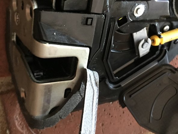

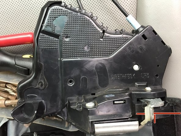

  14. 2012 Toyota Highlander Door Lock Actuator Motor Replacement, Disassemble the door lock actuator: crwdns2935265:014crwdnd2935265:01crwdnd2935265:02crwdne2935265:0 2012 Toyota Highlander Door Lock Actuator Motor Replacement, Disassemble the door lock actuator: crwdns2935265:014crwdnd2935265:02crwdnd2935265:02crwdne2935265:0
    • Carefully remove the weatherstrip and set aside. I reused this but if you prefer you can get some new weatherstrip.

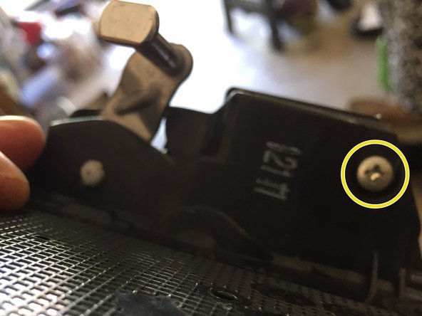

  15. 2012 Toyota Highlander Door Lock Actuator Motor Replacement, Disassemble the door lock actuator: crwdns2935265:015crwdnd2935265:01crwdnd2935265:03crwdne2935265:0 2012 Toyota Highlander Door Lock Actuator Motor Replacement, Disassemble the door lock actuator: crwdns2935265:015crwdnd2935265:02crwdnd2935265:03crwdne2935265:0 2012 Toyota Highlander Door Lock Actuator Motor Replacement, Disassemble the door lock actuator: crwdns2935265:015crwdnd2935265:03crwdnd2935265:03crwdne2935265:0
    • Remove two Phillips head fasteners as shown
    • One fastener is a bolt on the metal plate where the weatherstrip was just removed.
    • The other fastener is on the opposite side and is shown in the second two photos.

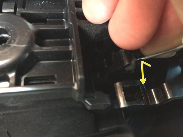

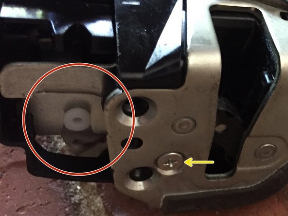

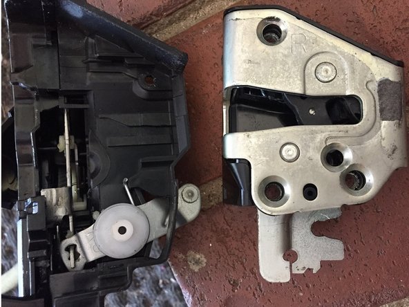

  16. 2012 Toyota Highlander Door Lock Actuator Motor Replacement, Disassemble the door lock actuator: crwdns2935265:016crwdnd2935265:01crwdnd2935265:02crwdne2935265:0 2012 Toyota Highlander Door Lock Actuator Motor Replacement, Disassemble the door lock actuator: crwdns2935265:016crwdnd2935265:02crwdnd2935265:02crwdne2935265:0
    • I this step we have to apply quite a bit of force to separate/release the latch mechanism containing the metal plate. The first photo shows white plastic part that is held tightly in the metal "V" notch has been released after pressing downward on the metal "shelf"
    • It took me quite a bit of wrestling to finally get this part separated from the rest of the actuator. In addition to the downward pressure, the insert needs to come outward.
    • Set the removed latch mechanism aside until reassembly.

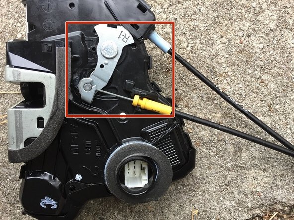

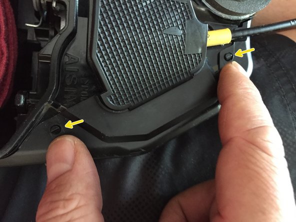

  17. 2012 Toyota Highlander Door Lock Actuator Motor Replacement, Disassemble the door lock actuator: crwdns2935265:017crwdnd2935265:01crwdnd2935265:03crwdne2935265:0 2012 Toyota Highlander Door Lock Actuator Motor Replacement, Disassemble the door lock actuator: crwdns2935265:017crwdnd2935265:02crwdnd2935265:03crwdne2935265:0 2012 Toyota Highlander Door Lock Actuator Motor Replacement, Disassemble the door lock actuator: crwdns2935265:017crwdnd2935265:03crwdnd2935265:03crwdne2935265:0
    • Remove the plastic cover on the edge of the actuator by slipping a flatblade screwdriver under the lip or lifting up at the lip of the cover where the holes are slipped over the plastic posts.
    • There are posts on both sides of the assembly.
    • There is also a flat plastic cover adjacent to the edge cover. Go ahead and pop that cover as well.
    • Set the plastic covers aside for reassembly.

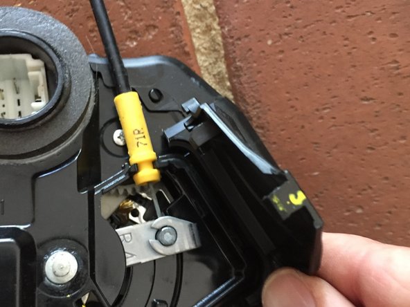

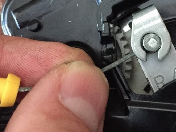

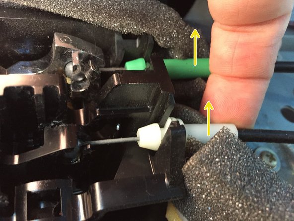

  18. 2012 Toyota Highlander Door Lock Actuator Motor Replacement, Disassemble the door lock actuator: crwdns2935265:018crwdnd2935265:01crwdnd2935265:03crwdne2935265:0 2012 Toyota Highlander Door Lock Actuator Motor Replacement, Disassemble the door lock actuator: crwdns2935265:018crwdnd2935265:02crwdnd2935265:03crwdne2935265:0 2012 Toyota Highlander Door Lock Actuator Motor Replacement, Disassemble the door lock actuator: crwdns2935265:018crwdnd2935265:03crwdnd2935265:03crwdne2935265:0
    • Lift the yellow cable barrel upward from the plastic holder where it enters the cavity that was protected by the removed flat plastic cover.
    • Rotate the braided cable towards the opening in the metal clamp and lift the cable up and out of the clamp and set it aside for reassembly.

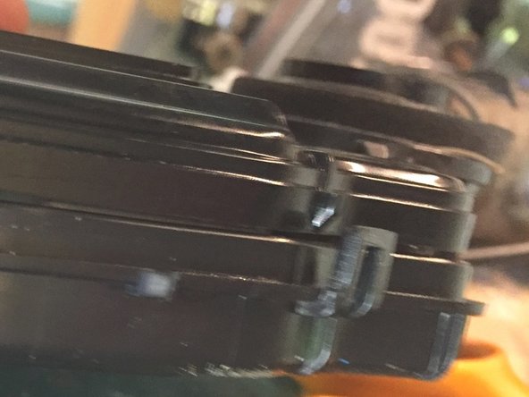

  20. 2012 Toyota Highlander Door Lock Actuator Motor Replacement, Open the door lock actuator assembly: crwdns2935265:020crwdnd2935265:01crwdnd2935265:03crwdne2935265:0 2012 Toyota Highlander Door Lock Actuator Motor Replacement, Open the door lock actuator assembly: crwdns2935265:020crwdnd2935265:02crwdnd2935265:03crwdne2935265:0 2012 Toyota Highlander Door Lock Actuator Motor Replacement, Open the door lock actuator assembly: crwdns2935265:020crwdnd2935265:03crwdnd2935265:03crwdne2935265:0
    • All along the edge of the assembly, there are plastic clips that are molded into the casing. Although these are quite tight, you can pry these clips carefully but firmly, one at a time, so that the case begins to open along this seam.
    • When I first started doing these I would use small nails to try to prop each clip to stay open as I moved from one to the next; however I found that it was ultimately not necessary as I was able to keep the previous clips open on their own.
    • There is one area along the case which has some additional plastic molding that gives some trouble releasing. Eventually with a bit of extra effort that area will also open up.

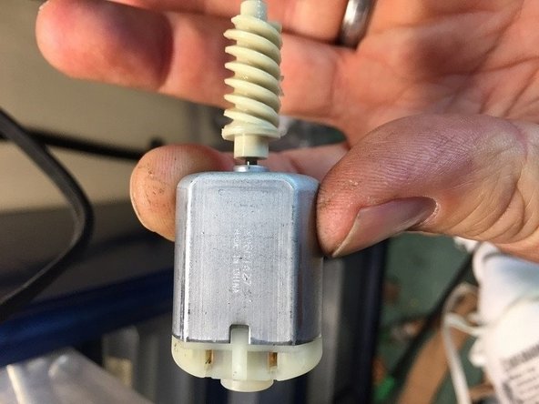

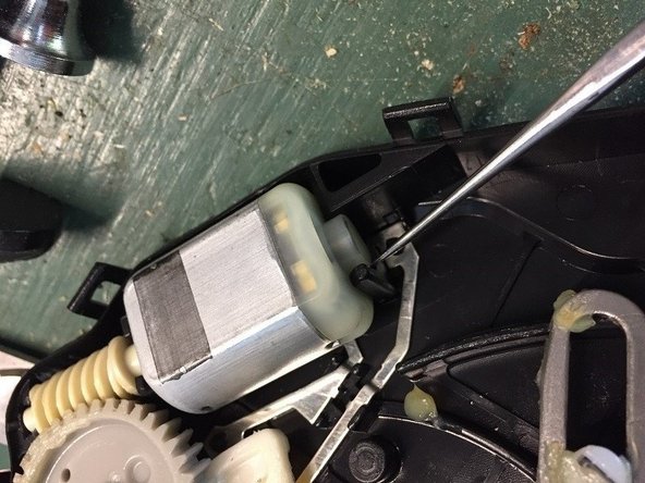

  21. 2012 Toyota Highlander Door Lock Actuator Motor Replacement, Replace the motor: crwdns2935265:021crwdnd2935265:01crwdnd2935265:03crwdne2935265:0 2012 Toyota Highlander Door Lock Actuator Motor Replacement, Replace the motor: crwdns2935265:021crwdnd2935265:02crwdnd2935265:03crwdne2935265:0 2012 Toyota Highlander Door Lock Actuator Motor Replacement, Replace the motor: crwdns2935265:021crwdnd2935265:03crwdnd2935265:03crwdne2935265:0
    • With the assembly case finally open, we can see the motor, gear and levers which drive the door lock actuator.
    • Take care not to disrupt the various levers , spring, etc. or else study the photo to ensure to get the parts back to their proper positions.
    • As it turns out, the motor is trivial to replace and all the effort has been spent simply getting access TO the motor!
    • Simply remove the motor by using a small screwdriver or pry tool to lift up on the rear of the housing.
    • With the motor removed, slide the gear off of the shaft and slide it back onto on the NEW motor. The shaft and shaft gear have a common flat side that allows the gear to properly fit onto the shaft.
    • Place the new motor into the actuator case where the old one was just removed.

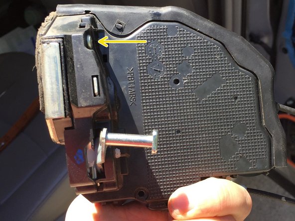

  23. 2012 Toyota Highlander Door Lock Actuator Motor Replacement, Re-attach the latch component: crwdns2935265:023crwdnd2935265:01crwdnd2935265:02crwdne2935265:0 2012 Toyota Highlander Door Lock Actuator Motor Replacement, Re-attach the latch component: crwdns2935265:023crwdnd2935265:02crwdnd2935265:02crwdne2935265:0
    • Slide the metal plate covered latch component back onto the assembly, making sure to engage that white round plastic portion from the main assembly into the notch in the latch component.
    • Secure the bolt back in through the metal plate and also install the remaining screw on the back side.
    • Re-install the weatherstrip around the latch mechanism edge where it was removed.
