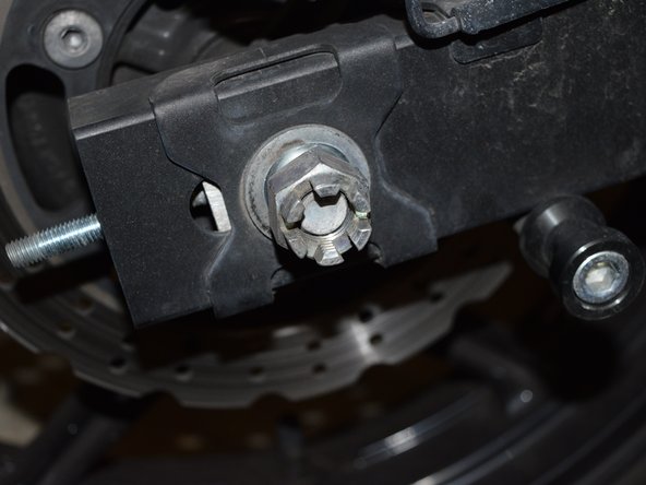

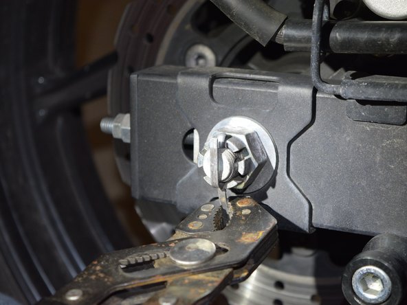

    • Locate the bolt that travels through the hub of the wheel
    • This will be the largest bolt of the back of the wheel
    • Remove the locking pin holding the nut in place
    • Use the grips to bend the pin straight
  4. 2012 Kawasaki Ninja Chain Tightening Replacement: crwdns2935265:04crwdnd2935265:01crwdnd2935265:03crwdne2935265:0 2012 Kawasaki Ninja Chain Tightening Replacement: crwdns2935265:04crwdnd2935265:02crwdnd2935265:03crwdne2935265:0 2012 Kawasaki Ninja Chain Tightening Replacement: crwdns2935265:04crwdnd2935265:03crwdnd2935265:03crwdne2935265:0

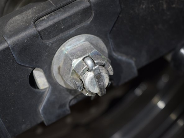

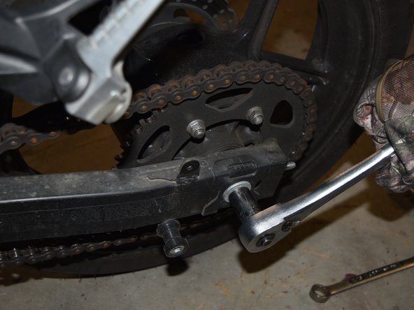

    • Place your 17mm socket on the bolt side and the 1 inch side over the nut
    • This is where the breaker bar would help as it could be very tight
    • Loosen the bolt to about half way
    • Do not take the bolt out or the nut off
