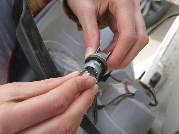

  5. 2012 Chevy Equinox Tail Light Bulb Replacement: crwdns2935265:05crwdnd2935265:01crwdnd2935265:03crwdne2935265:0 2012 Chevy Equinox Tail Light Bulb Replacement: crwdns2935265:05crwdnd2935265:02crwdnd2935265:03crwdne2935265:0 2012 Chevy Equinox Tail Light Bulb Replacement: crwdns2935265:05crwdnd2935265:03crwdnd2935265:03crwdne2935265:0
    • Remove the light bulb socket from the vehicle by gently twisting and pulling it out of the tail light cover.
  6. 2012 Chevy Equinox Tail Light Bulb Replacement: crwdns2935265:06crwdnd2935265:01crwdnd2935265:03crwdne2935265:0 2012 Chevy Equinox Tail Light Bulb Replacement: crwdns2935265:06crwdnd2935265:02crwdnd2935265:03crwdne2935265:0 2012 Chevy Equinox Tail Light Bulb Replacement: crwdns2935265:06crwdnd2935265:03crwdnd2935265:03crwdne2935265:0
    • Twist the light bulb counterclockwise and pull to remove it from the socket.
  7. 2012 Chevy Equinox Tail Light Bulb Replacement: crwdns2935265:07crwdnd2935265:01crwdnd2935265:03crwdne2935265:0 2012 Chevy Equinox Tail Light Bulb Replacement: crwdns2935265:07crwdnd2935265:02crwdnd2935265:03crwdne2935265:0 2012 Chevy Equinox Tail Light Bulb Replacement: crwdns2935265:07crwdnd2935265:03crwdnd2935265:03crwdne2935265:0
    • Insert the new light bulb by gently pushing the light bulb into the socket and twisting clockwise.
    • When reassembling, make sure to align the tail light cover up to the back of the vehicle before pushing the cover back on.
