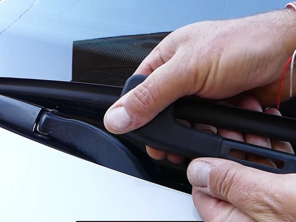

    • To begin, open the hood and make sure the broken wiper's body is completely positioned on the hood.
    • This is done to prevent scratches from developing throughout the repair process.

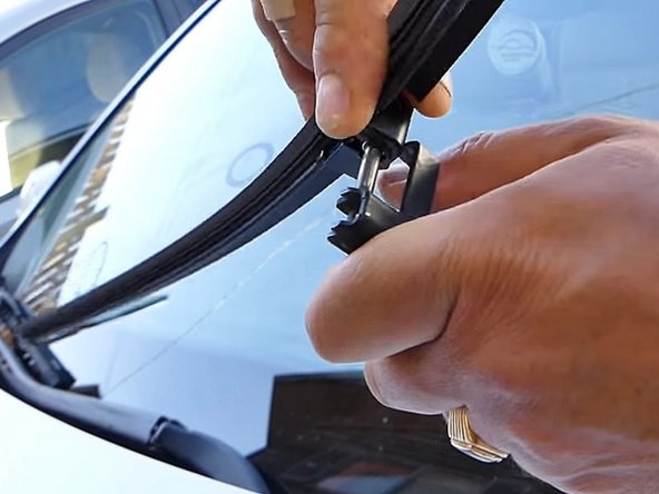

  2. 2012 BMW 3 Series Windshield Wiper Replacement: crwdns2935265:02crwdnd2935265:01crwdnd2935265:02crwdne2935265:0 2012 BMW 3 Series Windshield Wiper Replacement: crwdns2935265:02crwdnd2935265:02crwdnd2935265:02crwdne2935265:0
    • Use your fingers to pop the cover off that holds the wiper in place.

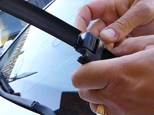

  3. 2012 BMW 3 Series Windshield Wiper Replacement: crwdns2935265:03crwdnd2935265:01crwdnd2935265:02crwdne2935265:0 2012 BMW 3 Series Windshield Wiper Replacement: crwdns2935265:03crwdnd2935265:02crwdnd2935265:02crwdne2935265:0
    • Use a back and forth motion to carefully remove the wiper blade from the wiper arm. and then pull it out.

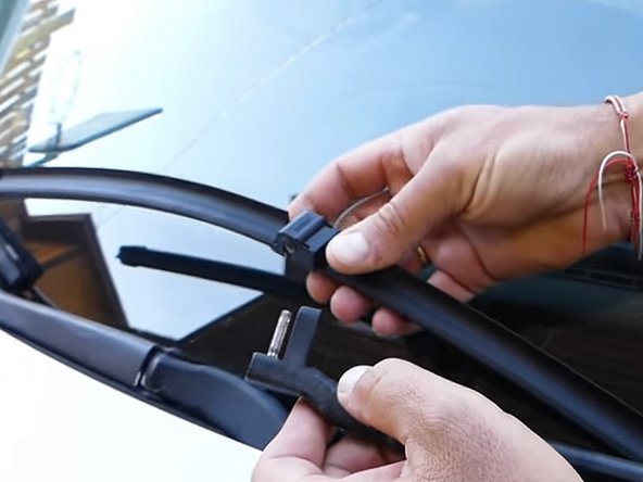

  4. 2012 BMW 3 Series Windshield Wiper Replacement: crwdns2935265:04crwdnd2935265:01crwdnd2935265:02crwdne2935265:0 2012 BMW 3 Series Windshield Wiper Replacement: crwdns2935265:04crwdnd2935265:02crwdnd2935265:02crwdne2935265:0
    • Install the replacement wiper so that the slightly bent angle side faces the vehicle.
