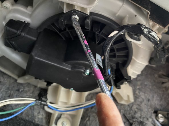

    • Locate your blower motor. Your blower motor should be below the glovebox.
  2. 2011 Scion Tc Blower Motor Replacement: crwdns2935265:02crwdnd2935265:01crwdnd2935265:01crwdne2935265:0
    • Remove the three 2 mm screws that secure the blower motor.
  3. 2011 Scion Tc Blower Motor Replacement: crwdns2935265:03crwdnd2935265:01crwdnd2935265:01crwdne2935265:0
    • Remove the two 1 mm Phillips #0 screws that secure the blower motor wiring harness.

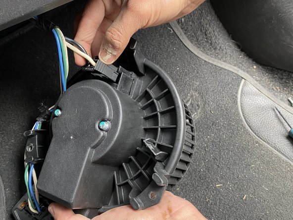

  4. 2011 Scion Tc Blower Motor Replacement: crwdns2935265:04crwdnd2935265:01crwdnd2935265:02crwdne2935265:0 2011 Scion Tc Blower Motor Replacement: crwdns2935265:04crwdnd2935265:02crwdnd2935265:02crwdne2935265:0
    • Disconnect the sensor that is connect to the blower motor.
    • The sensor should have a click and carefully remove it upwards.
  5. 2011 Scion Tc Blower Motor Replacement: crwdns2935265:05crwdnd2935265:01crwdnd2935265:02crwdne2935265:0 2011 Scion Tc Blower Motor Replacement: crwdns2935265:05crwdnd2935265:02crwdnd2935265:02crwdne2935265:0
    • Put the new blower motor in place, and secure it with the three 2 mm Phillips #0 screws.
  6. 2011 Scion Tc Blower Motor Replacement: crwdns2935265:06crwdnd2935265:01crwdnd2935265:01crwdne2935265:0
    • Tighten the two 1 mm screws to the wiring harness.
  7. 2011 Scion Tc Blower Motor Replacement: crwdns2935265:07crwdnd2935265:01crwdnd2935265:01crwdne2935265:0
    • Congratulations, you have successfully replaced your blower motor!
    • Once all the screws are tightened, just make sure to turn on your air to see if your blower motor works!
