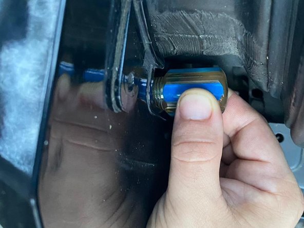

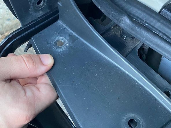

  3. 2011 Mitsubishi Outlander Bumper Taillight Replacement: crwdns2935265:03crwdnd2935265:01crwdnd2935265:02crwdne2935265:0 2011 Mitsubishi Outlander Bumper Taillight Replacement: crwdns2935265:03crwdnd2935265:02crwdnd2935265:02crwdne2935265:0
    • Pull back the plastic cover.

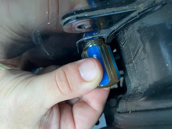

  4. 2011 Mitsubishi Outlander Bumper Taillight Replacement: crwdns2935265:04crwdnd2935265:01crwdnd2935265:03crwdne2935265:0 2011 Mitsubishi Outlander Bumper Taillight Replacement: crwdns2935265:04crwdnd2935265:02crwdnd2935265:03crwdne2935265:0 2011 Mitsubishi Outlander Bumper Taillight Replacement: crwdns2935265:04crwdnd2935265:03crwdnd2935265:03crwdne2935265:0
    • Insert the screwdriver and remove the small nut inside that hole.
    • This action can take a moment because there is no visibility of the screw. The action must be done by the user touch.

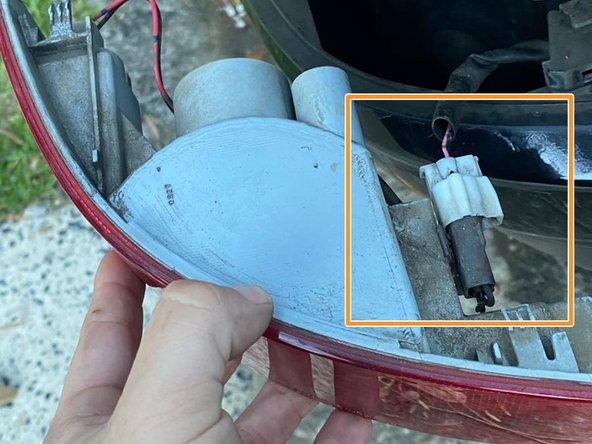

  5. 2011 Mitsubishi Outlander Bumper Taillight Replacement: crwdns2935265:05crwdnd2935265:01crwdnd2935265:02crwdne2935265:0 2011 Mitsubishi Outlander Bumper Taillight Replacement: crwdns2935265:05crwdnd2935265:02crwdnd2935265:02crwdne2935265:0
    • With the flat screwdriver remove the taillight housing.
    • Insert the flat screwdriver and slowly pull back to avoid damage the car paint.
    • Unplug the taillight housing.

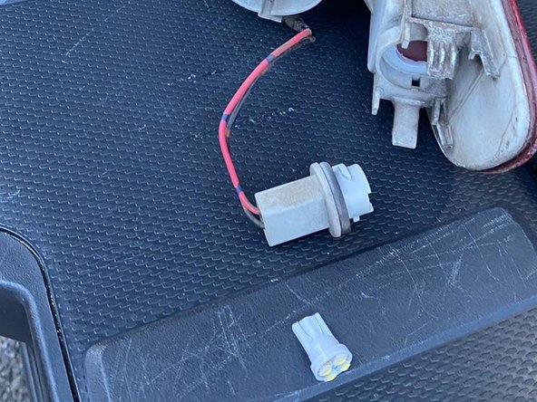

  6. 2011 Mitsubishi Outlander Bumper Taillight Replacement: crwdns2935265:06crwdnd2935265:01crwdnd2935265:02crwdne2935265:0 2011 Mitsubishi Outlander Bumper Taillight Replacement: crwdns2935265:06crwdnd2935265:02crwdnd2935265:02crwdne2935265:0
    • Turn the light housing connector counter clockwise and carefully pull it out of the casing.
To reassemble your device, follow these instructions in reverse order. Placing back the screw from step 3 can take a while.
