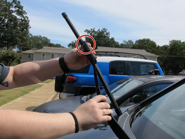

    • Take the driver's side wiper blade and pull it in a downward motion, releasing it from the wiper arm. Do the same for the passenger's side wiper blade.
    • Sometimes these joints can rust, especially if it has been a while since the last wiper blade replacement. If this is the case, just use a bit more force and it should release no problem.

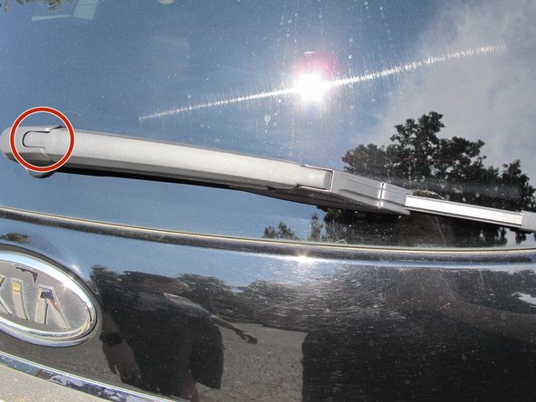

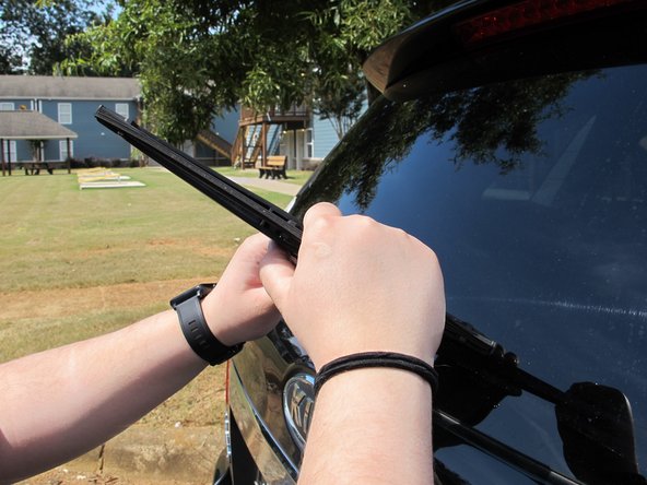

    • Pull up the rear windshield wiper from the windshield like you did for the front wipers.
    • It should be pointed towards you and stay in that position on its own.

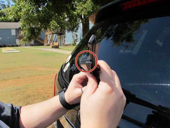

    • Twist the wiper blade to have the actual blade piece face you, then pull it from the wiper arm.
  6. 2011 Kia Sorento Windshield Wipers Replacement: crwdns2935265:06crwdnd2935265:01crwdnd2935265:03crwdne2935265:0 2011 Kia Sorento Windshield Wipers Replacement: crwdns2935265:06crwdnd2935265:02crwdnd2935265:03crwdne2935265:0 2011 Kia Sorento Windshield Wipers Replacement: crwdns2935265:06crwdnd2935265:03crwdnd2935265:03crwdne2935265:0
    • Take your new rear wiper blade (11 inch wiper blade), and push it onto the wiper arm and rotate it back to face the windshield.
    • Once you have ensured that the wiper blade is fully attached, push the wiper arm back onto the windshield.
