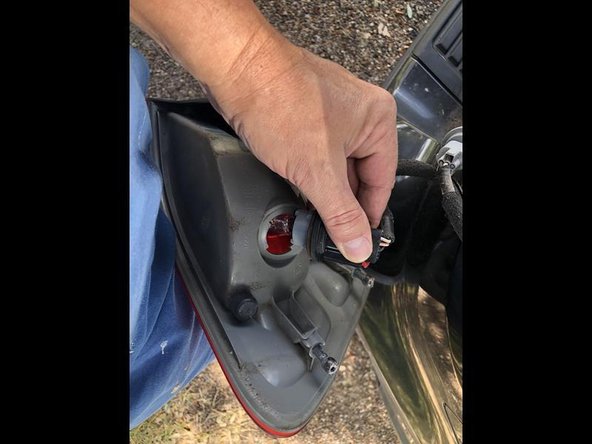

    • The lamp is now off the vehicle but the wiring is still connected.
    • Pull the lamp away from the vehicle far enough to access and disconnect the two body wire harness connectors
    • The smaller bottom connector (here right) is the back-up lamp and the larger one is the bulb for tail/stop/rear side marker/turn signal function. Grasp the bulb socket on the back of the rear lamp unit rotate it counterclockwise about 30 degrees to unlock it. Pull the socket and bulb straight out from the keyed opening in the housing.

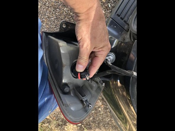

  5. 2011 Jeep Grand Cherokee Tail Light Replacement: crwdns2935265:05crwdnd2935265:01crwdnd2935265:03crwdne2935265:0 2011 Jeep Grand Cherokee Tail Light Replacement: crwdns2935265:05crwdnd2935265:02crwdnd2935265:03crwdne2935265:0 2011 Jeep Grand Cherokee Tail Light Replacement: crwdns2935265:05crwdnd2935265:03crwdnd2935265:03crwdne2935265:0
    • Here is the new aftermarket lens
    • Insert the bulb socket into the new lens opening lining up the notches from the socket and the lens.
    • Rotate the complete bulb socket about 30 degrees in a clockwise direction.
