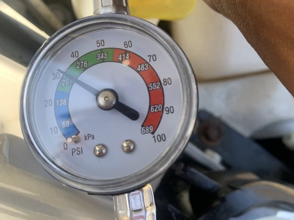

2011 Ford Focus Air Conditioning Refrigerant Replacement
  1. 2011 Ford Focus Air Conditioning  Refrigerant Replacement, Air Conditioning Refrigerant: crwdns2935265:01crwdnd2935265:01crwdnd2935265:03crwdne2935265:0 2011 Ford Focus Air Conditioning  Refrigerant Replacement, Air Conditioning Refrigerant: crwdns2935265:01crwdnd2935265:02crwdnd2935265:03crwdne2935265:0 2011 Ford Focus Air Conditioning  Refrigerant Replacement, Air Conditioning Refrigerant: crwdns2935265:01crwdnd2935265:03crwdnd2935265:03crwdne2935265:0
    • Turn the car on and the A/C to the maximum.
  2. 2011 Ford Focus Air Conditioning  Refrigerant Replacement: crwdns2935265:02crwdnd2935265:01crwdnd2935265:01crwdne2935265:0
    • Open your car's hood.
  3. 2011 Ford Focus Air Conditioning  Refrigerant Replacement: crwdns2935265:03crwdnd2935265:01crwdnd2935265:02crwdne2935265:0 2011 Ford Focus Air Conditioning  Refrigerant Replacement: crwdns2935265:03crwdnd2935265:02crwdnd2935265:02crwdne2935265:0
    • Locate the low-pressure charging port.
  4. 2011 Ford Focus Air Conditioning  Refrigerant Replacement: crwdns2935265:04crwdnd2935265:01crwdnd2935265:01crwdne2935265:0
    • Remove the cap by turning it counter-clockwise.
  5. 2011 Ford Focus Air Conditioning  Refrigerant Replacement: crwdns2935265:05crwdnd2935265:01crwdnd2935265:02crwdne2935265:0 2011 Ford Focus Air Conditioning  Refrigerant Replacement: crwdns2935265:05crwdnd2935265:02crwdnd2935265:02crwdne2935265:0
    • Connect the nozzle and hold the canister at a 3 o'clock angle.
    • Warning: Keep an eye on the PSI level. It should stay between 30 and 50, as going beyond 50 psi could cause the car's compressor to become damaged.
    • Lock and remove the canister if it is around 40 to prevent it from going to 50 psi.
    • Finally, start up the car. If the air conditioning is cooler, you'll know that it works!
