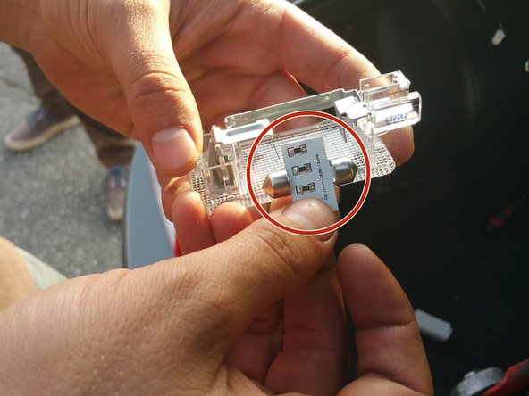

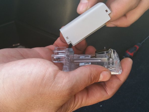

    • Remove back plate and switch from the unit to reveal the LED bulb.
  4. 2011-2013 Scion tC Trunk Light Replacement: crwdns2935265:04crwdnd2935265:01crwdnd2935265:02crwdne2935265:0 2011-2013 Scion tC Trunk Light Replacement: crwdns2935265:04crwdnd2935265:02crwdnd2935265:02crwdne2935265:0
    • Remove the LED from the casing by pulling upwards.
    • When inserting the replacement, take note of the direction and polarity of the unit.
