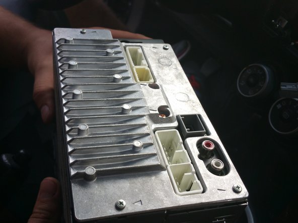

  4. 2011-2013 Scion tC Radio Head Unit Replacement: crwdns2935265:04crwdnd2935265:01crwdnd2935265:02crwdne2935265:0 2011-2013 Scion tC Radio Head Unit Replacement: crwdns2935265:04crwdnd2935265:02crwdnd2935265:02crwdne2935265:0
    • Remove each bundle of wires that is connected to the back of the head unit.

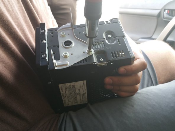

    • Locate the metal brackets on the side of the head unit.
    • Use a Philips head screwdriver, remove the three #2 25mm screws from both support brackets on the side of the head unit
  6. 2011-2013 Scion tC Radio Head Unit Replacement: crwdns2935265:06crwdnd2935265:01crwdnd2935265:01crwdne2935265:0
    • Screw the support brackets to the new radio head unit
    • Note that the brackets are unique to the car. They will not come with your new head unit.
