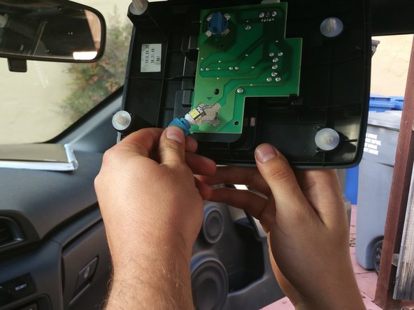

    • Remove the plastic covering of the lights by pulling it down quickly from the windshield side.
  2. 2011-2013 Scion tC Front Dome Light Replacement: crwdns2935265:02crwdnd2935265:01crwdnd2935265:01crwdne2935265:0
    • Disconnect the plastic header from system by pressing inward on the side tabs.
  3. 2011-2013 Scion tC Front Dome Light Replacement: crwdns2935265:03crwdnd2935265:01crwdnd2935265:02crwdne2935265:0 2011-2013 Scion tC Front Dome Light Replacement: crwdns2935265:03crwdnd2935265:02crwdnd2935265:02crwdne2935265:0

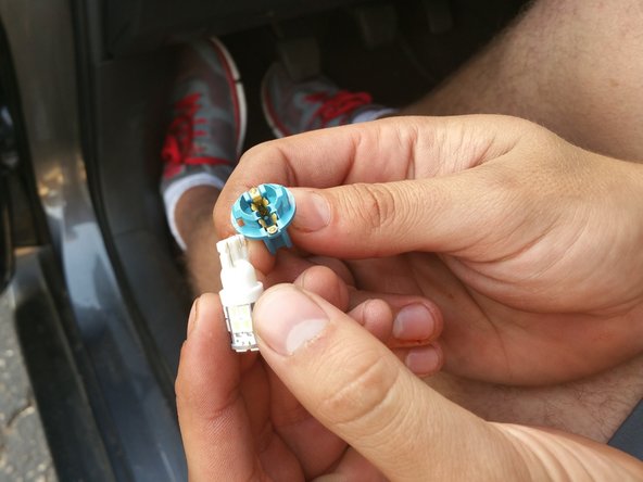

    • Turn blue knobs counter clockwise and pull to remove bulb housing.
  4. 2011-2013 Scion tC Front Dome Light Replacement: crwdns2935265:04crwdnd2935265:01crwdnd2935265:02crwdne2935265:0 2011-2013 Scion tC Front Dome Light Replacement: crwdns2935265:04crwdnd2935265:02crwdnd2935265:02crwdne2935265:0
    • Pull burnt bulb out of knob/housing.
    • When inserting the replacement, take note of the direction and polarity of the unit.
To reassemble the dome, follow these instructions in reverse order.
