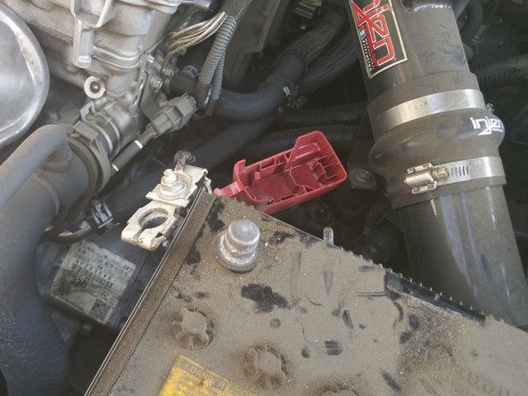

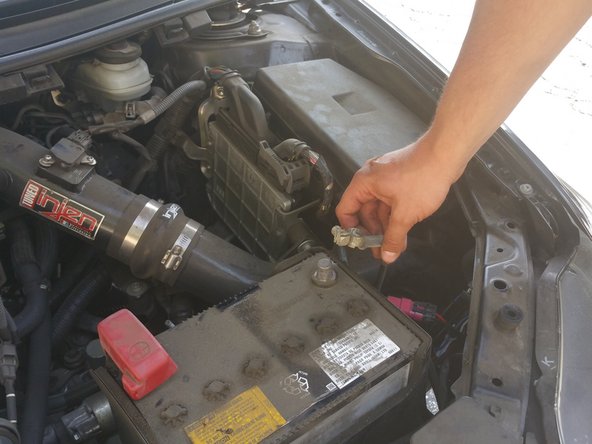

    • Start with the negative terminal of the battery
    • Loosen the nut on the negative terminal with a 10mm socket wrench
    • Remove the wire by slightly twisting and pulling up
  5. 2011-2013 Scion tC Car Battery Replacement: crwdns2935265:05crwdnd2935265:01crwdnd2935265:02crwdne2935265:0 2011-2013 Scion tC Car Battery Replacement: crwdns2935265:05crwdnd2935265:02crwdnd2935265:02crwdne2935265:0
    • Remove the cap from the positive terminal of the battery
    • Using a 10mm socket wrench, loosen the nut on the positive terminal
    • Remove the wire from the positive terminal by slightly twisting and pulling up
