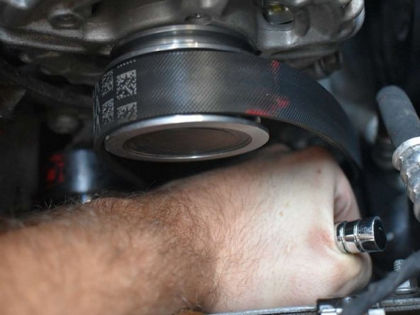

  7. 2011- 2017 Volkswagen Jetta Alternator Replacement, Locate belt loosening bolt​: crwdns2935265:07crwdnd2935265:01crwdnd2935265:01crwdne2935265:0
    • The belt loosening bolt is on the left, below the alternator.
  8. 2011- 2017 Volkswagen Jetta Alternator Replacement, Loosen bolt: crwdns2935265:08crwdnd2935265:01crwdnd2935265:02crwdne2935265:0 2011- 2017 Volkswagen Jetta Alternator Replacement, Loosen bolt: crwdns2935265:08crwdnd2935265:02crwdnd2935265:02crwdne2935265:0
    • Using 11/16 in. socket, rotate clockwise to loosen the bolt
    Generalmente todo es milimétrico así que deberían usar una llave 17 mm
    Juan Alfredo Garza Hernández - crwdns2934203:0crwdne2934203:0
  9. 2011- 2017 Volkswagen Jetta Alternator Replacement, Remove belt: crwdns2935265:09crwdnd2935265:01crwdnd2935265:01crwdne2935265:0
    • Push the belt off of the alternator.
    • Do not completely remove belt from engine.

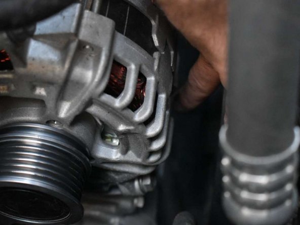

  10. 2011- 2017 Volkswagen Jetta Alternator Replacement, Locate screws holding the alternator in place: crwdns2935265:010crwdnd2935265:01crwdnd2935265:02crwdne2935265:0 2011- 2017 Volkswagen Jetta Alternator Replacement, Locate screws holding the alternator in place: crwdns2935265:010crwdnd2935265:02crwdnd2935265:02crwdne2935265:0
    • Locate the 4 screws holding the alternator in place two on the top and two on the bottom.
  11. 2011- 2017 Volkswagen Jetta Alternator Replacement, Remove screws from alternator: crwdns2935265:011crwdnd2935265:01crwdnd2935265:02crwdne2935265:0 2011- 2017 Volkswagen Jetta Alternator Replacement, Remove screws from alternator: crwdns2935265:011crwdnd2935265:02crwdnd2935265:02crwdne2935265:0
    • Using the 1/2 in. socket, remove the screws.
  12. 2011- 2017 Volkswagen Jetta Alternator Replacement, Remove cap and electrical connector: crwdns2935265:012crwdnd2935265:01crwdnd2935265:01crwdne2935265:0
    • Remove cap and electrical connector located on the right side of the alternator before removing the alternator.
    • Photo was taken after the alternator was removed to provide a better picture.

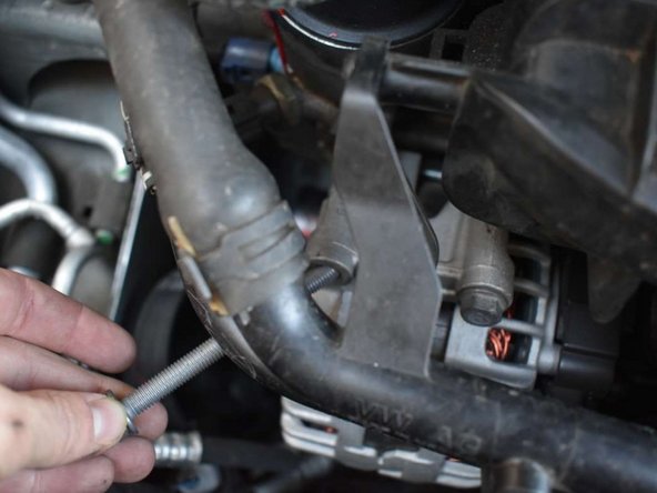

  13. 2011- 2017 Volkswagen Jetta Alternator Replacement, Remove the alternator: crwdns2935265:013crwdnd2935265:01crwdnd2935265:01crwdne2935265:0
    • Take alternator out of engine by pulling to the left and out.

What engine is this guide for?
Colin Smith - crwdns2934203:0crwdne2934203:0
Don’t think you can get the alternator out without tying back the coolant hose in the way and probably removing the fans as there is not enough space to get it out otherwise idk how this guide managed to.
