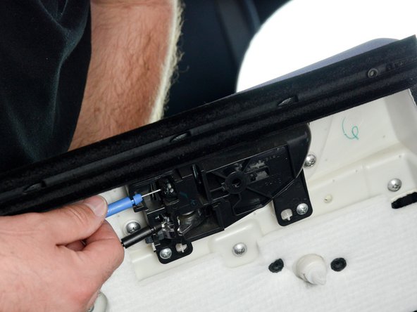

    • Insert the metal ball into the plastic door pull handle assembly.
    • With the ball inserted, route the steel cable through the assembly and align the black plastic notch on the cable with the plastic notch on the door pull handle assembly.
    • Press the cable notch into the door pull handle notch and snap it into place.
  2. 2010-Present Subaru Legacy Rear Door Reassembly: crwdns2935265:02crwdnd2935265:01crwdnd2935265:01crwdne2935265:0
    • Hold the door lock in the "unlocked" position with your thumb. This will make it easier to insert the metal ball into the door lock assembly.
  3. 2010-Present Subaru Legacy Rear Door Reassembly: crwdns2935265:03crwdnd2935265:01crwdnd2935265:02crwdne2935265:0 2010-Present Subaru Legacy Rear Door Reassembly: crwdns2935265:03crwdnd2935265:02crwdnd2935265:02crwdne2935265:0
    • Insert the metal ball into the plastic door lock assembly.
    • With the ball inserted, route the steel cable through the assembly and align the blue plastic notch on the cable with the plastic notch on the door lock assembly.
    • Press the cable notch into the door lock notch and snap it into place.
