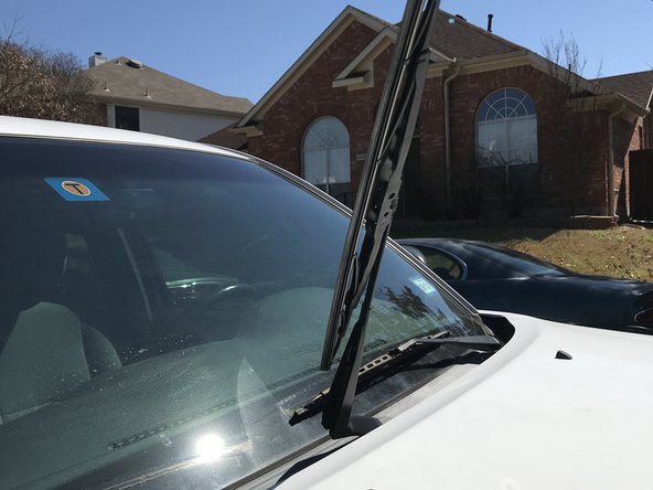

    • Pull the windshield wiper up off the glass.
