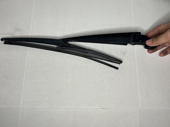

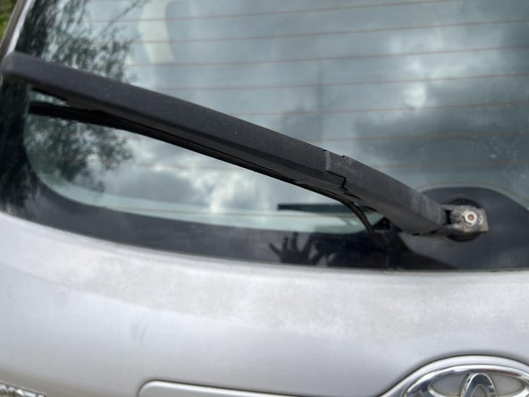

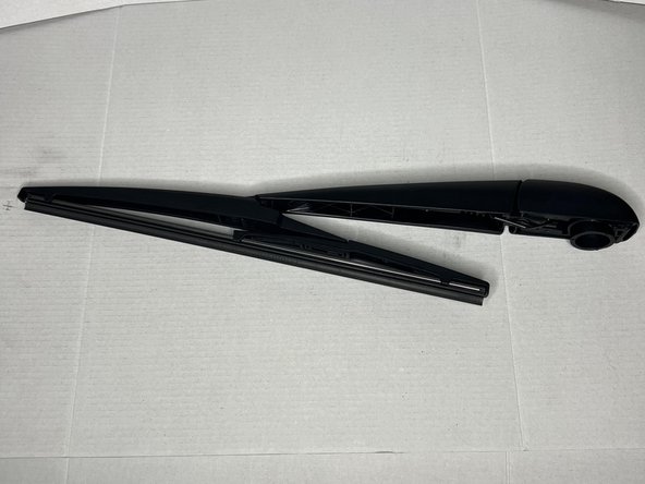

    • Observe the entire rear windshield wiper and see where the arm and rear windshield wiper is.
    • The arm section is near where the base is. The base is where the entire rear windshield wiper is attached to.
    • The other section that is not attached to base is the rear windshield wiper blade.

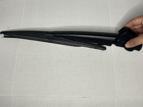

    • Remove the back cover of the rear windshield wiper arm on the end.

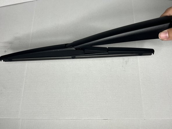

    • Lift the entire rear windshield wiper and the arm up.

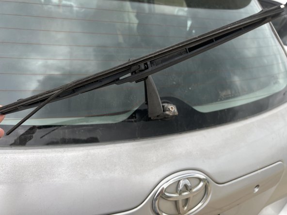

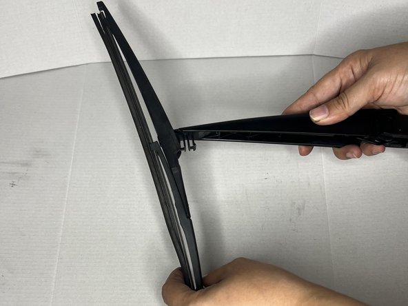

    • Rotate the rear wiper perpendicular to the holder until you hear a click.
    • The length of the rear wiper should be facing towards you.
  5. 2010 Toyota Matrix Rear Windshield Wiper Replacement: crwdns2935265:05crwdnd2935265:01crwdnd2935265:03crwdne2935265:0 2010 Toyota Matrix Rear Windshield Wiper Replacement: crwdns2935265:05crwdnd2935265:02crwdnd2935265:03crwdne2935265:0 2010 Toyota Matrix Rear Windshield Wiper Replacement: crwdns2935265:05crwdnd2935265:03crwdnd2935265:03crwdne2935265:0

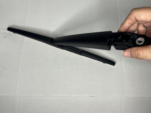

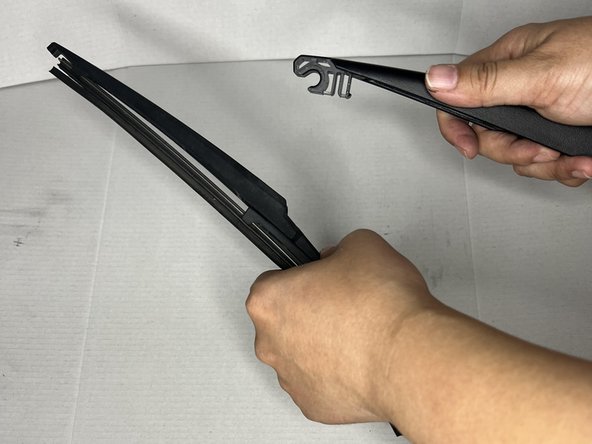

    • Pull out or detach the old rear wiper blade from the rear wiper arm.
    • You should hear click as it detaches.
  6. 2010 Toyota Matrix Rear Windshield Wiper Replacement: crwdns2935265:06crwdnd2935265:01crwdnd2935265:03crwdne2935265:0 2010 Toyota Matrix Rear Windshield Wiper Replacement: crwdns2935265:06crwdnd2935265:02crwdnd2935265:03crwdne2935265:0 2010 Toyota Matrix Rear Windshield Wiper Replacement: crwdns2935265:06crwdnd2935265:03crwdnd2935265:03crwdne2935265:0

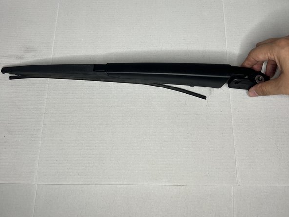

    • Insert the semi-circle hook of the arm wiper into the new wiper blade opening in the middle.
    • Attach the semi-circle arm hook onto the new wiper blade.
    • Once click is heard, then the new wiper blade is attached.
    • Once the new wiper blade is attached, you can bring down the arm.
