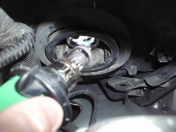

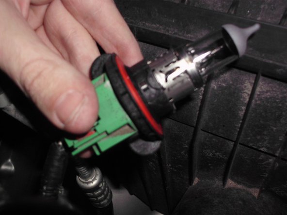

    • Identify the bulb socket, located behind the headlight.
    • Rotate the base of the bulb counter-clockwise to remove it from the socket.
    • Remove the bulb from the green base by pulling the two apart.
  3. 2010 Jeep Liberty Headlight Bulb Replacement: crwdns2935265:03crwdnd2935265:01crwdnd2935265:03crwdne2935265:0 2010 Jeep Liberty Headlight Bulb Replacement: crwdns2935265:03crwdnd2935265:02crwdnd2935265:03crwdne2935265:0 2010 Jeep Liberty Headlight Bulb Replacement: crwdns2935265:03crwdnd2935265:03crwdnd2935265:03crwdne2935265:0
    • Insert the new bulb into the green base.
    • Be sure not to touch the glass with your fingers. If you do, wipe the bulb down with a soft cloth and some rubbing alcohol. Oils left behind from your fingers can shorten the life of the bulb.
    • Rotate clockwise to lock the bulb assembly into the socket.
