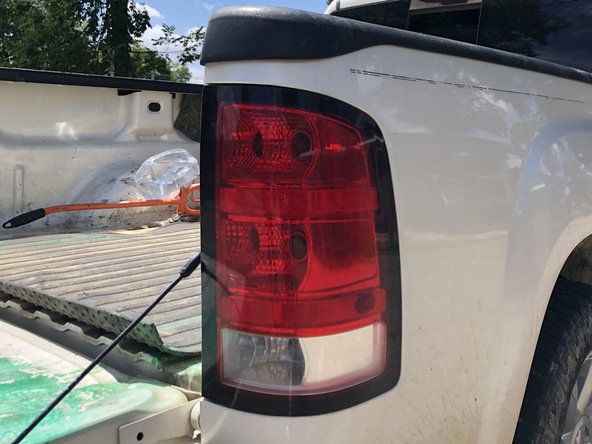

    • Lower the tail gate fully.
    • Remove objects near tail light.

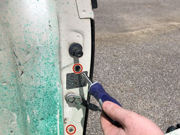

  3. 2010 GMC Sierra Tail Light Replacement: crwdns2935265:03crwdnd2935265:01crwdnd2935265:02crwdne2935265:0 2010 GMC Sierra Tail Light Replacement: crwdns2935265:03crwdnd2935265:02crwdnd2935265:02crwdne2935265:0

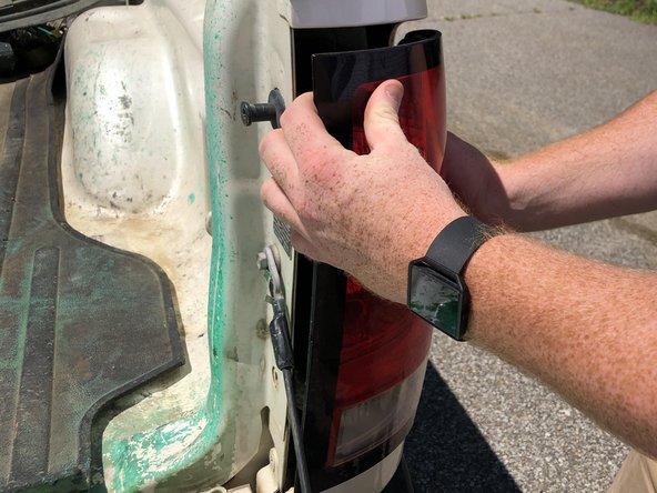

    • Using the Philips screwdriver, remove the two 4.8x16mm screws securing the housing.

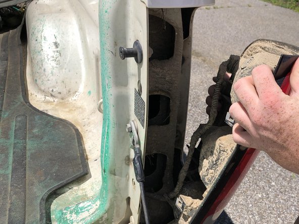

  4. 2010 GMC Sierra Tail Light Replacement: crwdns2935265:04crwdnd2935265:01crwdnd2935265:02crwdne2935265:0 2010 GMC Sierra Tail Light Replacement: crwdns2935265:04crwdnd2935265:02crwdnd2935265:02crwdne2935265:0
    • Pry the housing free.
    • Be mindful of wires and dust.

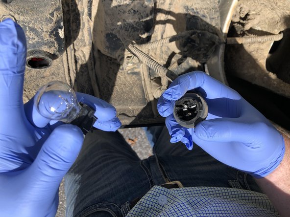

  5. 2010 GMC Sierra Tail Light Replacement: crwdns2935265:05crwdnd2935265:01crwdnd2935265:02crwdne2935265:0 2010 GMC Sierra Tail Light Replacement: crwdns2935265:05crwdnd2935265:02crwdnd2935265:02crwdne2935265:0

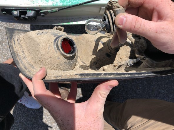

    • Rotate the harness counterclockwise.
    • Pull the harness free from the housing.

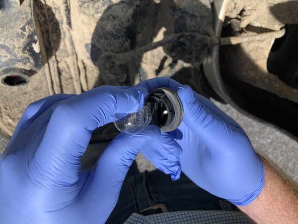

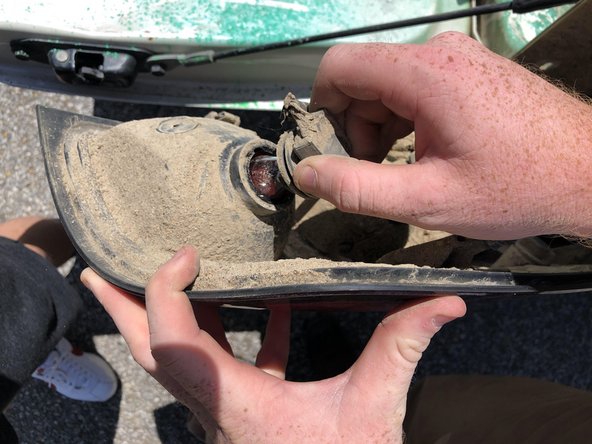

  6. 2010 GMC Sierra Tail Light Replacement: crwdns2935265:06crwdnd2935265:01crwdnd2935265:02crwdne2935265:0 2010 GMC Sierra Tail Light Replacement: crwdns2935265:06crwdnd2935265:02crwdnd2935265:02crwdne2935265:0
    • Wearing the latex gloves, pull the bad bulb out of the harness.
    • Skin oil shortens the bulbs' life spans.
