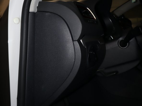

    • Locate the vehicle's fusebox. On this model of the Golf, it will be located on the interior panel of the dashboard on the driver's side of the car.
  3. 2010-2013 Volkswagen Golf Fuse Replacement: crwdns2935265:03crwdnd2935265:01crwdnd2935265:01crwdne2935265:0
    • Gently pry the trim piece off of the front of the panel to open the fuse box.

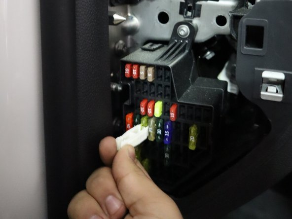

  4. 2010-2013 Volkswagen Golf Fuse Replacement: crwdns2935265:04crwdnd2935265:01crwdnd2935265:01crwdne2935265:0
    • On the back of the fuse box's cover panel, there will be a fuse puller attached. Locate this piece prior to removing any of the vehicle's fuses.
    • Use the attached fuse puller, or something of similar size and material. Equipment of the wrong material or size can damage the vehicle's fuse panel.

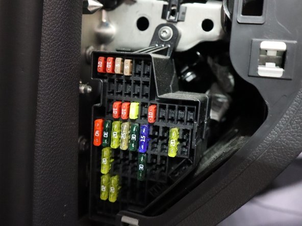

  5. 2010-2013 Volkswagen Golf Fuse Replacement: crwdns2935265:05crwdnd2935265:01crwdnd2935265:02crwdne2935265:0 2010-2013 Volkswagen Golf Fuse Replacement: crwdns2935265:05crwdnd2935265:02crwdnd2935265:02crwdne2935265:0
    • Identify and remove the blown fuse: Each fuse piece is labeled. The correct fuse for the ECU is number 24. Your vehicle's manual will also include a diagram of the fuse box's layout.
    • Note that the number on the fuse does not correspond to the fuse's location, but rather to the amperage rating of the fuse itself.
  6. 2010-2013 Volkswagen Golf Fuse Replacement: crwdns2935265:06crwdnd2935265:01crwdnd2935265:03crwdne2935265:0 2010-2013 Volkswagen Golf Fuse Replacement: crwdns2935265:06crwdnd2935265:02crwdnd2935265:03crwdne2935265:0 2010-2013 Volkswagen Golf Fuse Replacement: crwdns2935265:06crwdnd2935265:03crwdnd2935265:03crwdne2935265:0
    • Using the fuse puller, place the new fuse into the empty slot for fuse 24, and ensure that the replacement fuse fits firmly.
  7. 2010-2013 Volkswagen Golf Fuse Replacement: crwdns2935265:07crwdnd2935265:01crwdnd2935265:02crwdne2935265:0 2010-2013 Volkswagen Golf Fuse Replacement: crwdns2935265:07crwdnd2935265:02crwdnd2935265:02crwdne2935265:0

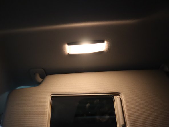

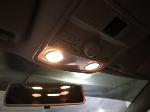

  8. 2010-2013 Volkswagen Golf Fuse Replacement: crwdns2935265:08crwdnd2935265:01crwdnd2935265:03crwdne2935265:0 2010-2013 Volkswagen Golf Fuse Replacement: crwdns2935265:08crwdnd2935265:02crwdnd2935265:03crwdne2935265:0 2010-2013 Volkswagen Golf Fuse Replacement: crwdns2935265:08crwdnd2935265:03crwdnd2935265:03crwdne2935265:0
    • Insert the key into the vehicle's ignition, and place the vehicle into accessory mode. Confirm that the vehicle's lights turn on and function as normally.
If the fuse is working, congratulations! If you're still having trouble, try asking around here to get some help.
