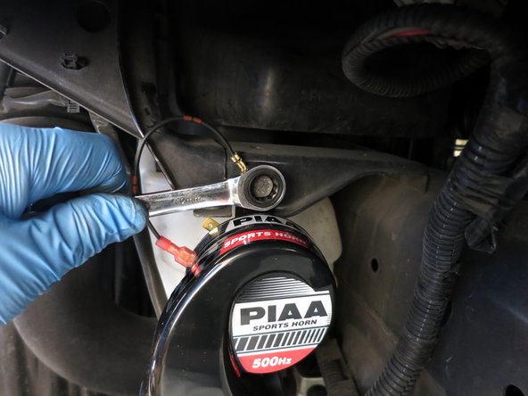

    • These are the [stock] horns you are looking for. One is located on the left-side of the radiator (when looking at the car), while the other one is next to the air intake / water tank.
    • Both horns are identical in terms of disassembly/replacement. The one mounted near the radiator is a bit harder to access, since the hex bolt is obscured by a frame -- but it's not that much more difficult to remove.
  2. 2010-2014 Subaru Legacy Horn Replacement: crwdns2935265:02crwdnd2935265:01crwdnd2935265:01crwdne2935265:0
    • Use a 12 mm wrench to remove the bolt holding the horn in place.

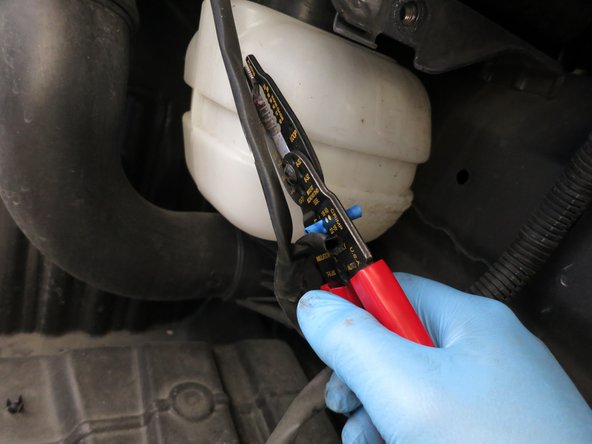

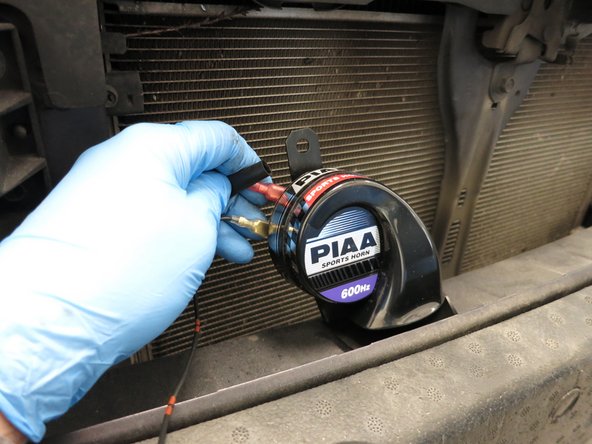

    • Unplug the power connector from the horn, and use a wire stripper to expose a bare portion of the wire. The "20 ga" hole seemed the best fit for this purpose.
    • The PIAA horns have their power/ground connections on top of the horn, so the stock wire won't be long enough. At the same time, the ground cables that come with the horns are too long -- which is a perfect hack in this case!

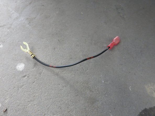

    • Snip about 4" of the ground cable wire (the 1/4" female spade connector side) and use a butt connector to attach it to the horn's power wire.
    • It may be a good idea to insulate the connection with some electrical tape after it's been crimped properly.
  4. 2010-2014 Subaru Legacy Horn Replacement: crwdns2935265:04crwdnd2935265:01crwdnd2935265:03crwdne2935265:0 2010-2014 Subaru Legacy Horn Replacement: crwdns2935265:04crwdnd2935265:02crwdnd2935265:03crwdne2935265:0 2010-2014 Subaru Legacy Horn Replacement: crwdns2935265:04crwdnd2935265:03crwdnd2935265:03crwdne2935265:0

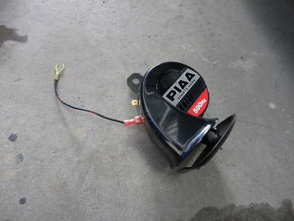

    • Now you should have a shortened ground cable with a bare wire on one end, and that half-loop connector on the other.
    • Attach another 1/4" female spade connector to the end of the ground cable, and plug it into the lower of the two male spade connectors on the PIAA horn.
  5. 2010-2014 Subaru Legacy Horn Replacement: crwdns2935265:05crwdnd2935265:01crwdnd2935265:03crwdne2935265:0 2010-2014 Subaru Legacy Horn Replacement: crwdns2935265:05crwdnd2935265:02crwdnd2935265:03crwdne2935265:0 2010-2014 Subaru Legacy Horn Replacement: crwdns2935265:05crwdnd2935265:03crwdnd2935265:03crwdne2935265:0

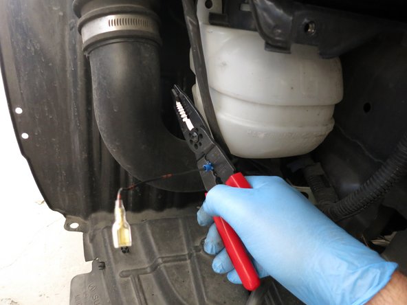

    • The factory bolt is a bit larger in diameter than the half-circle connector will allow -- unless it is expanded! So insert a needle-nose plier into the center for the connector and then spread it apart in order to accommodate the bolt.
    • Route the bolt through the horn's mounting hole.
    • Screw the bolt / ground wire / horn assembly into the factory mounting hole.

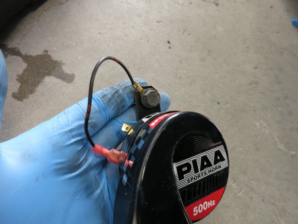

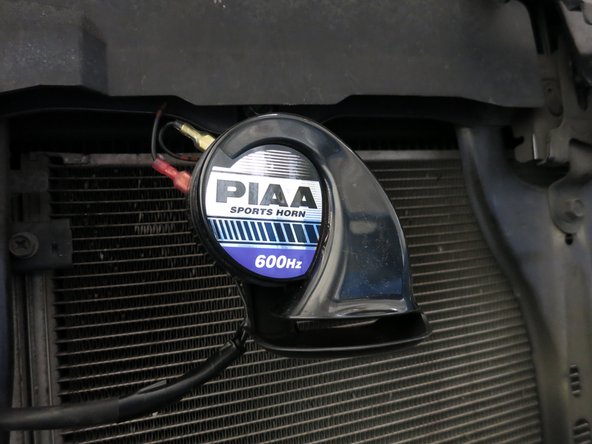

    • Plug in the DC power line into the top male connector of the horn. The final wiring / horn assembly can be seen in the first image.
    • Once you're done with the first horn, the second should be the same exact procedure -- so go get 'em!
    • So that's it! Here's a before-and-after horn comparison, so you get an idea of the sound difference.
    • I don't believe the PIAAs are that much more loud, but they are definitely a nicer sounding setup than the stock honkers.
