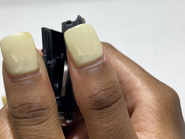

    • At the bottom half of the key with the control panel, place your thumb and index finger in between the side opposite the alarm.
    • Apply force to separate the halves, noting too much force will cause the old battery to move or fall out. If it does not fall out, use the screwdriver to remove the old battery.
