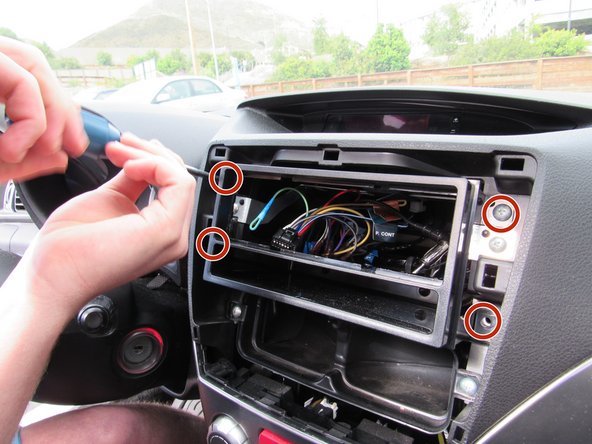

    • Insert a plastic trim removal tool or pry tool into the seam behind the trim surround, and twist lightly.
    • If you don't have a trim removal tool, you can use a thin flathead screwdriver—but be careful not to damage the trim or dash materials.
    • Use your hands to slowly pry off the rest of the trim surround.

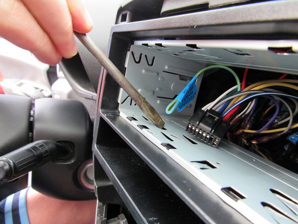

    • Remove the four 8x3/4" Phillips screws highlighted. Then slowly slide the stereo out from its housing.

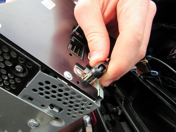

    • Unplug both the white and black wiring harnesses by pressing the small tab above the socket connector.
    • Remove the antennae cord by sliding it from its housing.

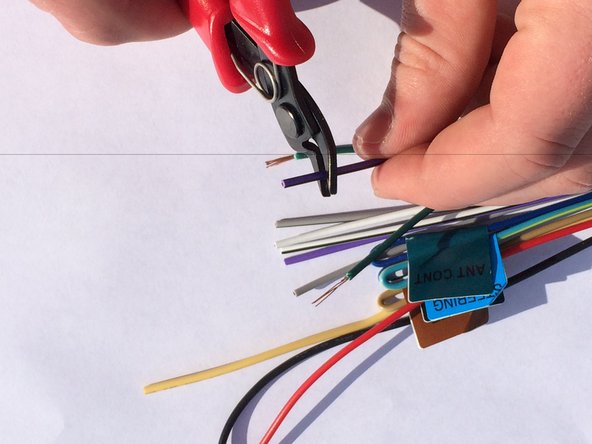

    • Locate your aftermarket wiring harness included with the aftermarket stereo.
    • Strip each wire necessary for installation (See Table in Step 7).

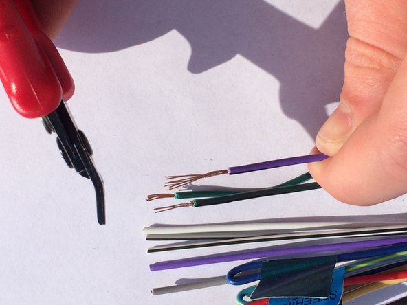

  5. 2009 Subaru Impreza WRX Stereo Replacement: crwdns2935265:05crwdnd2935265:01crwdnd2935265:02crwdne2935265:0 2009 Subaru Impreza WRX Stereo Replacement: crwdns2935265:05crwdnd2935265:02crwdnd2935265:02crwdne2935265:0
    • Locate the white wiring harness behind the stereo housing.
    • Cut the cords to separate the wires connecting the harness to the car's electrical system.
    • Note: Be careful not to cut the black wiring harness instead. The black harness is for the CD changer and isn't used in this installation.

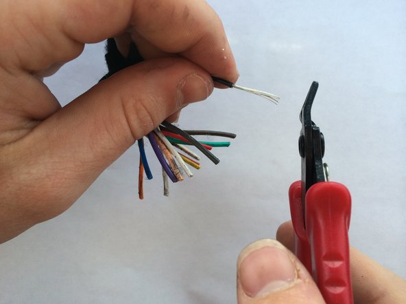

    • Strip each wire in the wiring harness necessary for installation.
    • Be careful while stripping the wires. They are extremely brittle and tend to rip easily.
    • Once both the OEM white wiring harness and the black aftermarket wiring harness are stripped, bring the two ends together to start comparing which wires need to be connected.
