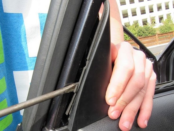

  5. 2009 Subaru Impreza WRX Rear Speaker Replacement: crwdns2935265:05crwdnd2935265:01crwdnd2935265:02crwdne2935265:0 2009 Subaru Impreza WRX Rear Speaker Replacement: crwdns2935265:05crwdnd2935265:02crwdnd2935265:02crwdne2935265:0
    • Use flathead to pry off the upper panel located at the top of the rear door panel.
  6. 2009 Subaru Impreza WRX Rear Speaker Replacement: crwdns2935265:06crwdnd2935265:01crwdnd2935265:02crwdne2935265:0 2009 Subaru Impreza WRX Rear Speaker Replacement: crwdns2935265:06crwdnd2935265:02crwdnd2935265:02crwdne2935265:0
    • Use the flathead screwdriver to pry off and remove the panel over the door handle.

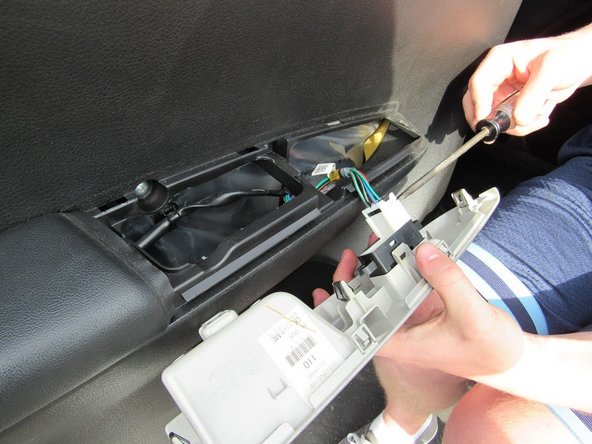

  7. 2009 Subaru Impreza WRX Rear Speaker Replacement: crwdns2935265:07crwdnd2935265:01crwdnd2935265:01crwdne2935265:0
    • Remove the bundle of wires from the panel by pressing the tabs on the sides of the large white plastic connector.
  8. 2009 Subaru Impreza WRX Rear Speaker Replacement: crwdns2935265:08crwdnd2935265:01crwdnd2935265:01crwdne2935265:0
    • Use the Phillips screwdriver to unscrew the 8x3/4" screws behind the door handle panel that was just removed.

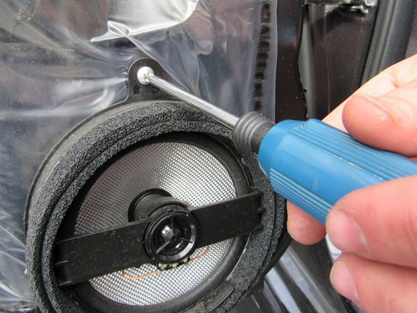

  12. 2009 Subaru Impreza WRX Rear Speaker Replacement, Rear Speaker: crwdns2935265:012crwdnd2935265:01crwdnd2935265:02crwdne2935265:0 2009 Subaru Impreza WRX Rear Speaker Replacement, Rear Speaker: crwdns2935265:012crwdnd2935265:02crwdnd2935265:02crwdne2935265:0
    • Locate and remove all three Phillips 8x3/4" screws. There's one on top and two on the sides where the arrows are pointing.
  13. 2009 Subaru Impreza WRX Rear Speaker Replacement: crwdns2935265:013crwdnd2935265:01crwdnd2935265:01crwdne2935265:0
    • Once the screws are removed, the speaker will easily pop out of the door revealing two wires attached to the speaker with a white clip. Remove this white clip by simply squeezing one of the tabs that lock it in place.

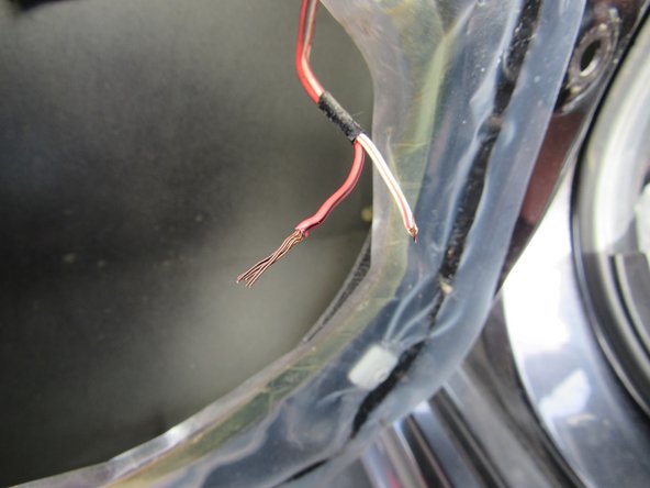

  14. 2009 Subaru Impreza WRX Rear Speaker Replacement: crwdns2935265:014crwdnd2935265:01crwdnd2935265:01crwdne2935265:0
    • Once the clip is removed from the speaker, you will want to then cut the wires from the white clip using a wire cutters.
  15. 2009 Subaru Impreza WRX Rear Speaker Replacement: crwdns2935265:015crwdnd2935265:01crwdnd2935265:02crwdne2935265:0 2009 Subaru Impreza WRX Rear Speaker Replacement: crwdns2935265:015crwdnd2935265:02crwdnd2935265:02crwdne2935265:0
    • Once the white clip is removed from the wires, you will then want to strip about 0.5" of plastic from the wire revealing bare copper wire.
  16. 2009 Subaru Impreza WRX Rear Speaker Replacement: crwdns2935265:016crwdnd2935265:01crwdnd2935265:01crwdne2935265:0
    • Once the wires are cut, you will then want to add separate clips on the end of the wires by placing the clips on the wires, and then using a pliers, squeeze the plastic to crimp the clip securely on the wire.

This would be A LOT MORE HELPFUL, if OP wrote which wires were positive and which were negative..
