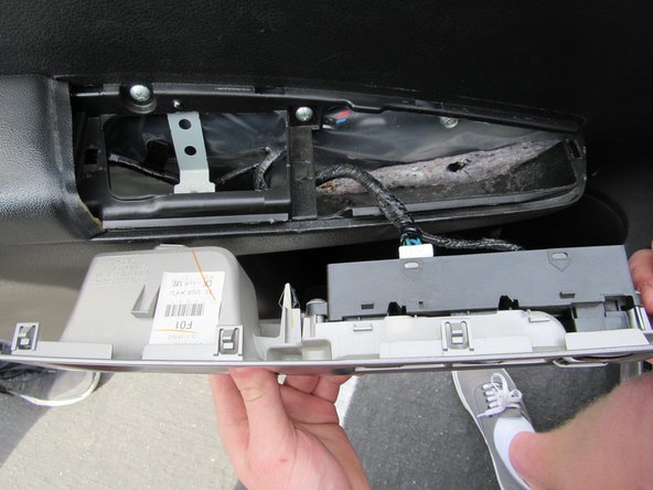

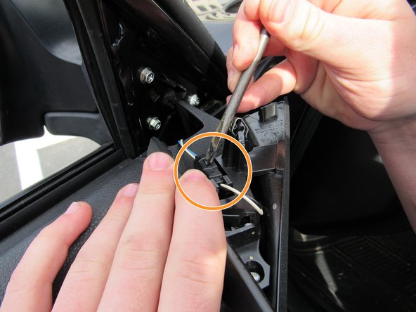

  4. 2009 Subaru Impreza WRX Front Speaker Replacement: crwdns2935265:04crwdnd2935265:01crwdnd2935265:02crwdne2935265:0 2009 Subaru Impreza WRX Front Speaker Replacement: crwdns2935265:04crwdnd2935265:02crwdnd2935265:02crwdne2935265:0
    • Pry off the entire door speaker and its housing located inside of the mirror.
    • Using your flathead screwdriver, pry up the latch connecting the two white cords and disconnect the speaker.

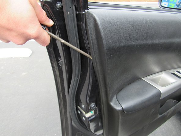

  8. 2009 Subaru Impreza WRX Front Speaker Replacement: crwdns2935265:08crwdnd2935265:01crwdnd2935265:02crwdne2935265:0 2009 Subaru Impreza WRX Front Speaker Replacement: crwdns2935265:08crwdnd2935265:02crwdnd2935265:02crwdne2935265:0
    • Pry the left side of the door panel away from the door using a flathead screwdriver.
    • It may be easiest to start by prying away where the red circle is located.

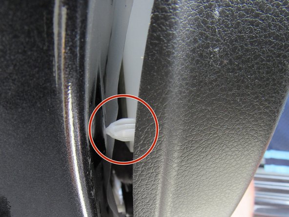

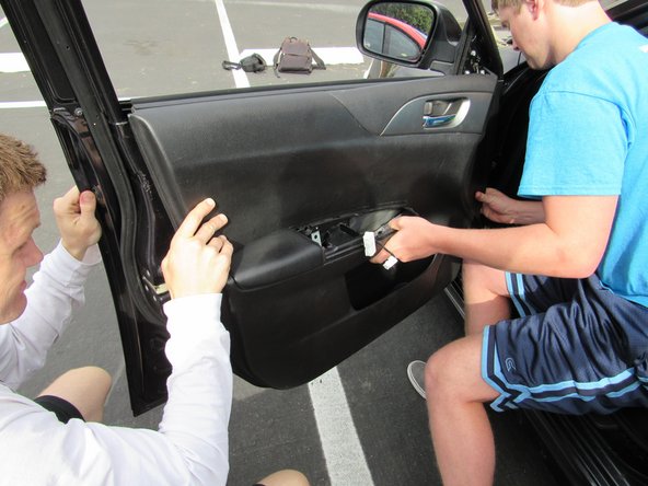

  10. 2009 Subaru Impreza WRX Front Speaker Replacement: crwdns2935265:010crwdnd2935265:01crwdnd2935265:02crwdne2935265:0 2009 Subaru Impreza WRX Front Speaker Replacement: crwdns2935265:010crwdnd2935265:02crwdnd2935265:02crwdne2935265:0
    • Finish pulling the door off of the frame, now that all the clips have been disconnected.
    • Pull the door from the top, not the bottom or sides.

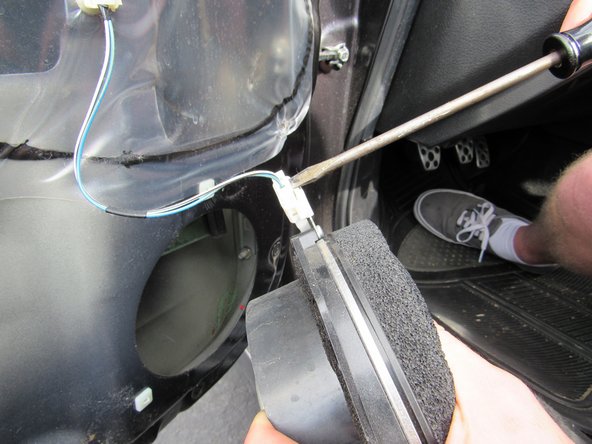

    • There will be a plastic adapter connecting wires to the speaker. To separate the adapter from the speaker, use a flathead screwdriver or spudger to pry the adapter off.
  15. 2009 Subaru Impreza WRX Front Speaker Replacement: crwdns2935265:015crwdnd2935265:01crwdnd2935265:01crwdne2935265:0
    • Remove the plastic adapter from the wiring using wire cutters as shown.

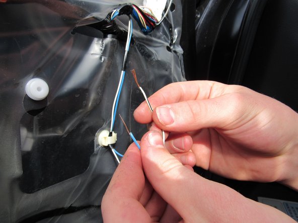

  16. 2009 Subaru Impreza WRX Front Speaker Replacement: crwdns2935265:016crwdnd2935265:01crwdnd2935265:02crwdne2935265:0 2009 Subaru Impreza WRX Front Speaker Replacement: crwdns2935265:016crwdnd2935265:02crwdnd2935265:02crwdne2935265:0
    • Using wire strippers, strip the two wires shown (blue and white, respectively) at about 1 inch from the end.

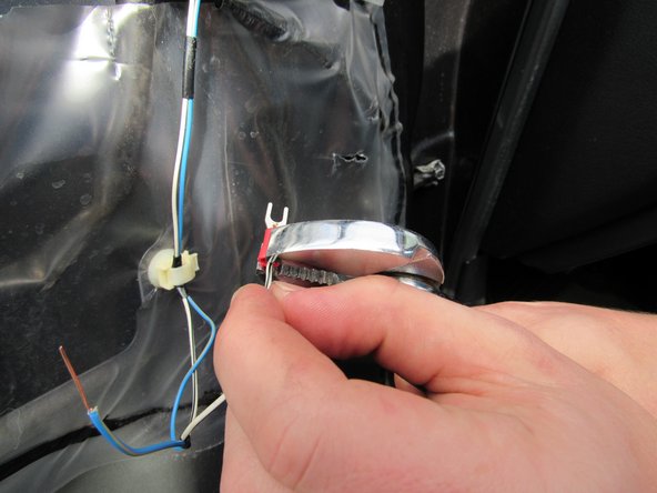

  17. 2009 Subaru Impreza WRX Front Speaker Replacement: crwdns2935265:017crwdnd2935265:01crwdnd2935265:02crwdne2935265:0 2009 Subaru Impreza WRX Front Speaker Replacement: crwdns2935265:017crwdnd2935265:02crwdnd2935265:02crwdne2935265:0
    • Using pliers, attach a special adapter piece to both wires as shown. Simply insert the wire into the plastic cavity and apply pressure.

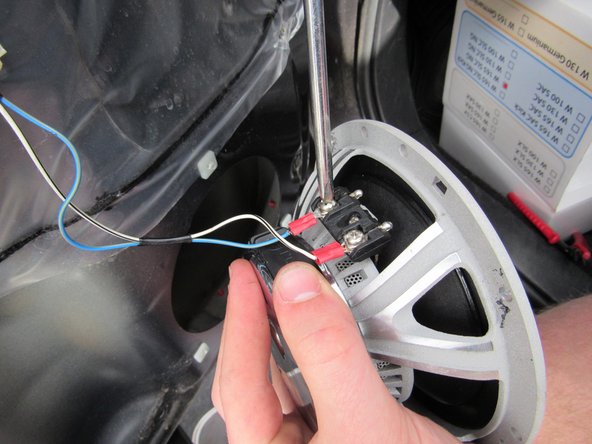

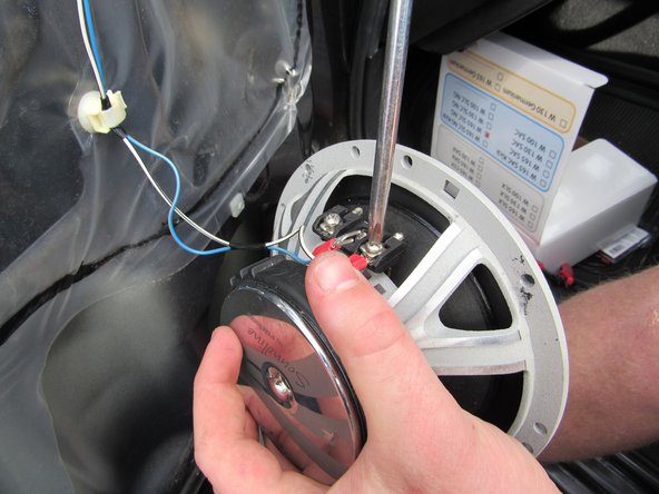

  18. 2009 Subaru Impreza WRX Front Speaker Replacement: crwdns2935265:018crwdnd2935265:01crwdnd2935265:03crwdne2935265:0 2009 Subaru Impreza WRX Front Speaker Replacement: crwdns2935265:018crwdnd2935265:02crwdnd2935265:03crwdne2935265:0 2009 Subaru Impreza WRX Front Speaker Replacement: crwdns2935265:018crwdnd2935265:03crwdnd2935265:03crwdne2935265:0
    • Locate the part of your new speaker which has two 8x3/4" Phillips screws in line. Unscrew these screws slightly to allow the adapter pieces to fit under them, then screw them back in to secure the wires.
    • Make sure the wiring connector is fully tightened under screw.

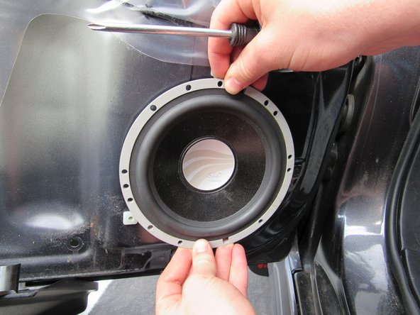

  19. 2009 Subaru Impreza WRX Front Speaker Replacement: crwdns2935265:019crwdnd2935265:01crwdnd2935265:02crwdne2935265:0 2009 Subaru Impreza WRX Front Speaker Replacement: crwdns2935265:019crwdnd2935265:02crwdnd2935265:02crwdne2935265:0
    • The final step is to place the new speaker, and tighten the same three screws as before to secure it.
