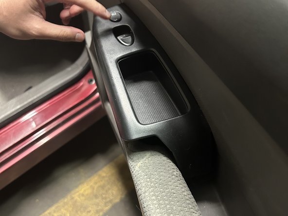

    • Place a prying tool in the small crevice at the centre of the window controller and pry upwards.
  4. 2009 Honda Civic Window Regulator Replacement: crwdns2935265:04crwdnd2935265:01crwdnd2935265:02crwdne2935265:0 2009 Honda Civic Window Regulator Replacement: crwdns2935265:04crwdnd2935265:02crwdnd2935265:02crwdne2935265:0
    • Disconnect the electrical connectors attached to the panel by pressing onto the tab.

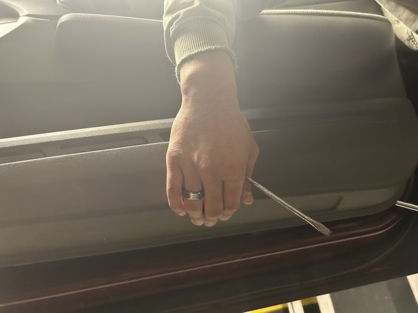

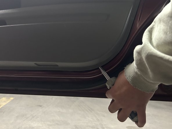

  5. 2009 Honda Civic Window Regulator Replacement: crwdns2935265:05crwdnd2935265:01crwdnd2935265:03crwdne2935265:0 2009 Honda Civic Window Regulator Replacement: crwdns2935265:05crwdnd2935265:02crwdnd2935265:03crwdne2935265:0 2009 Honda Civic Window Regulator Replacement: crwdns2935265:05crwdnd2935265:03crwdnd2935265:03crwdne2935265:0
    • Use a prying tool to pry off the door panel.

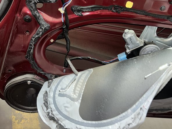

  7. 2009 Honda Civic Window Regulator Replacement: crwdns2935265:07crwdnd2935265:01crwdnd2935265:02crwdne2935265:0 2009 Honda Civic Window Regulator Replacement: crwdns2935265:07crwdnd2935265:02crwdnd2935265:02crwdne2935265:0
    • Use a prying tool to remove the two black plugs on the left-hand side and right-hand side of the plastic liner.
  8. 2009 Honda Civic Window Regulator Replacement: crwdns2935265:08crwdnd2935265:01crwdnd2935265:02crwdne2935265:0 2009 Honda Civic Window Regulator Replacement: crwdns2935265:08crwdnd2935265:02crwdnd2935265:02crwdne2935265:0
    • Remove the connector by pushing onto the tab using a prying tool.
  9. 2009 Honda Civic Window Regulator Replacement: crwdns2935265:09crwdnd2935265:01crwdnd2935265:02crwdne2935265:0 2009 Honda Civic Window Regulator Replacement: crwdns2935265:09crwdnd2935265:02crwdnd2935265:02crwdne2935265:0
    • Gently remove the plastic liner.

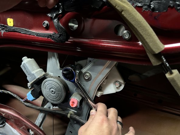

  10. 2009 Honda Civic Window Regulator Replacement: crwdns2935265:010crwdnd2935265:01crwdnd2935265:02crwdne2935265:0 2009 Honda Civic Window Regulator Replacement: crwdns2935265:010crwdnd2935265:02crwdnd2935265:02crwdne2935265:0
    • Use a wrench to remove the two bolts located at the left-hand side and right-hand side.
  11. 2009 Honda Civic Window Regulator Replacement: crwdns2935265:011crwdnd2935265:01crwdnd2935265:03crwdne2935265:0 2009 Honda Civic Window Regulator Replacement: crwdns2935265:011crwdnd2935265:02crwdnd2935265:03crwdne2935265:0 2009 Honda Civic Window Regulator Replacement: crwdns2935265:011crwdnd2935265:03crwdnd2935265:03crwdne2935265:0
    • Use the wrench to unscrew the first bolt located at the top of the door in a counterclockwise motion.
    • Use the wrench to unscrew the second bolt located at the bottom of the door in a counterclockwise motion.
  12. 2009 Honda Civic Window Regulator Replacement: crwdns2935265:012crwdnd2935265:01crwdnd2935265:02crwdne2935265:0 2009 Honda Civic Window Regulator Replacement: crwdns2935265:012crwdnd2935265:02crwdnd2935265:02crwdne2935265:0
    • After removing all four bolts, use your hands to remove the window regulator.
