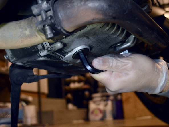

    • First, place a small bucket right below the hexagonal socket that is located under the motorcycle.
  2. 2009 Ducati Hypermotard 1100 Oil Replacement: crwdns2935265:02crwdnd2935265:01crwdnd2935265:02crwdne2935265:0 2009 Ducati Hypermotard 1100 Oil Replacement: crwdns2935265:02crwdnd2935265:02crwdnd2935265:02crwdne2935265:0
    • Next, remove the drainage bolt with the 3/8 Allen wrench.
    • Twist the bolt clockwise until it is loose enough to twist off with your fingers.
    • Remember to be careful when removing the bolt because the oil could potentially be hot if the motorcycle was turned on before.

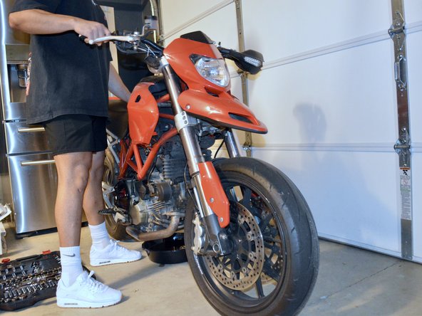

  3. 2009 Ducati Hypermotard 1100 Oil Replacement: crwdns2935265:03crwdnd2935265:01crwdnd2935265:02crwdne2935265:0 2009 Ducati Hypermotard 1100 Oil Replacement: crwdns2935265:03crwdnd2935265:02crwdnd2935265:02crwdne2935265:0
    • Once the drainage bolt has been removed, place it to the side and wait for the old oil to drain out.
    • When the oil is just about done draining, tilt the motorcycle left and right to make sure all the oil is out of the engine as shown in the second image.

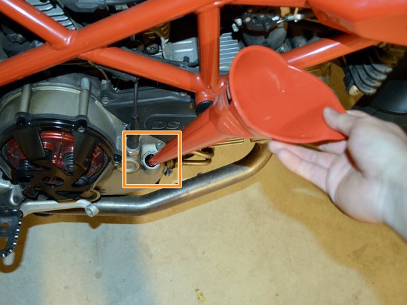

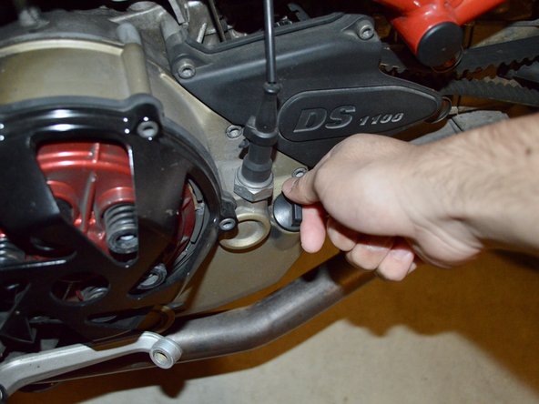

  4. 2009 Ducati Hypermotard 1100 Oil Replacement: crwdns2935265:04crwdnd2935265:01crwdnd2935265:03crwdne2935265:0 2009 Ducati Hypermotard 1100 Oil Replacement: crwdns2935265:04crwdnd2935265:02crwdnd2935265:03crwdne2935265:0 2009 Ducati Hypermotard 1100 Oil Replacement: crwdns2935265:04crwdnd2935265:03crwdnd2935265:03crwdne2935265:0
    • After your old oil has drained completely; remove the oil cap by twisting clockwise with your hands as shown in the second image.
    • Next, insert the funnel into the engine as shown in the image.
  5. 2009 Ducati Hypermotard 1100 Oil Replacement: crwdns2935265:05crwdnd2935265:01crwdnd2935265:01crwdne2935265:0
    • Pour in about 0.5 quart of oil into the funnel and let it drain out in order to wash out the old oil.
    • This step should be performed before you replace the drainage bolt.
