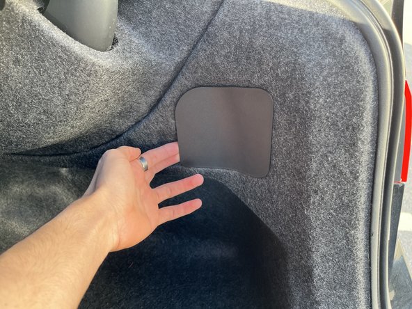

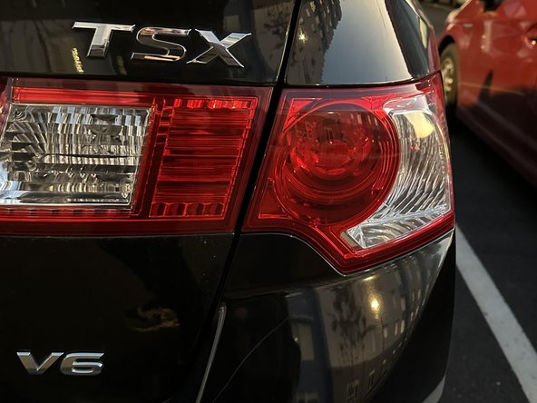

    • Open the trunk of your car and and remove all items.
  2. 2009-2014 Acura TSX Brake Light Replacement: crwdns2935265:02crwdnd2935265:01crwdnd2935265:03crwdne2935265:0 2009-2014 Acura TSX Brake Light Replacement: crwdns2935265:02crwdnd2935265:02crwdnd2935265:03crwdne2935265:0 2009-2014 Acura TSX Brake Light Replacement: crwdns2935265:02crwdnd2935265:03crwdnd2935265:03crwdne2935265:0
    • Use your hands or a spudger to remove the plastic panel from the interior lining.

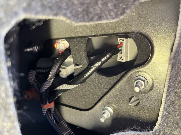

  3. 2009-2014 Acura TSX Brake Light Replacement: crwdns2935265:03crwdnd2935265:01crwdnd2935265:03crwdne2935265:0 2009-2014 Acura TSX Brake Light Replacement: crwdns2935265:03crwdnd2935265:02crwdnd2935265:03crwdne2935265:0 2009-2014 Acura TSX Brake Light Replacement: crwdns2935265:03crwdnd2935265:03crwdnd2935265:03crwdne2935265:0
    • Twist the grey rectangular plug counterclockwise until you hear a click.
    • Pull the plug with the light attached from the socket.

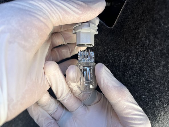

  4. 2009-2014 Acura TSX Brake Light Replacement: crwdns2935265:04crwdnd2935265:01crwdnd2935265:02crwdne2935265:0 2009-2014 Acura TSX Brake Light Replacement: crwdns2935265:04crwdnd2935265:02crwdnd2935265:02crwdne2935265:0
    • Put on gloves because any oil or dirt on the bulb will cause heat to concentrate on that spot and lower the life of the bulb significantly.
    • With gloves, carefully remove the bulb from the socket.

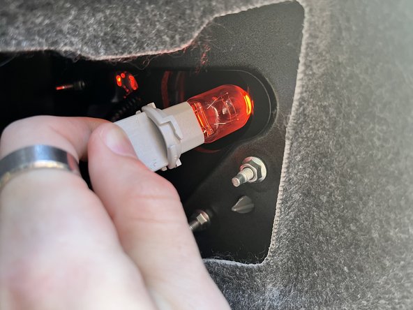

  5. 2009-2014 Acura TSX Brake Light Replacement: crwdns2935265:05crwdnd2935265:01crwdnd2935265:03crwdne2935265:0 2009-2014 Acura TSX Brake Light Replacement: crwdns2935265:05crwdnd2935265:02crwdnd2935265:03crwdne2935265:0 2009-2014 Acura TSX Brake Light Replacement: crwdns2935265:05crwdnd2935265:03crwdnd2935265:03crwdne2935265:0
    • Take the replacement light bulb and carefully insert it into the socket with gentle pressure until it clicks.

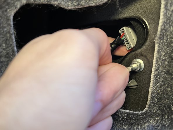

  6. 2009-2014 Acura TSX Brake Light Replacement: crwdns2935265:06crwdnd2935265:01crwdnd2935265:03crwdne2935265:0 2009-2014 Acura TSX Brake Light Replacement: crwdns2935265:06crwdnd2935265:02crwdnd2935265:03crwdne2935265:0 2009-2014 Acura TSX Brake Light Replacement: crwdns2935265:06crwdnd2935265:03crwdnd2935265:03crwdne2935265:0
    • Insert the plug with the new bulb back into the socket at a 45 degree angle to the left.
    • Twist the plug clockwise until you hear a click.
  7. 2009-2014 Acura TSX Brake Light Replacement: crwdns2935265:07crwdnd2935265:01crwdnd2935265:02crwdne2935265:0 2009-2014 Acura TSX Brake Light Replacement: crwdns2935265:07crwdnd2935265:02crwdnd2935265:02crwdne2935265:0
    • Replace the plastic panel to cover the light sockets.

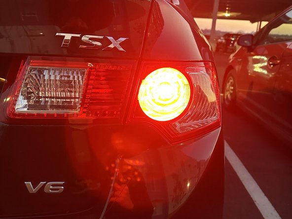

  8. 2009-2014 Acura TSX Brake Light Replacement: crwdns2935265:08crwdnd2935265:01crwdnd2935265:03crwdne2935265:0 2009-2014 Acura TSX Brake Light Replacement: crwdns2935265:08crwdnd2935265:02crwdnd2935265:03crwdne2935265:0 2009-2014 Acura TSX Brake Light Replacement: crwdns2935265:08crwdnd2935265:03crwdnd2935265:03crwdne2935265:0
    • Turn on the vehicle and test the breaks to ensure the bulb is working properly.
    • If light does not turn on, check if the brake light bulb is properly plugged in to the grey socket or you may need to try a different bulb.
This is for passenger side tail light. If drivers side it is same steps just mirrored.
