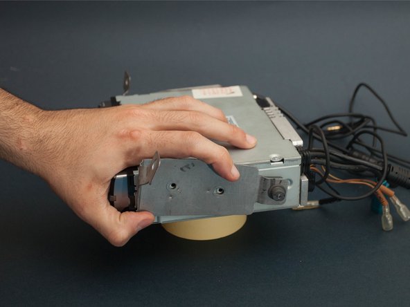

    • Unscrew mounting plates from original headunit to custom headunit.
  5. 2009-2015 Suzuki Alto Head Unit Replacement, installing the mounting plates: crwdns2935265:05crwdnd2935265:01crwdnd2935265:03crwdne2935265:0 2009-2015 Suzuki Alto Head Unit Replacement, installing the mounting plates: crwdns2935265:05crwdnd2935265:02crwdnd2935265:03crwdne2935265:0 2009-2015 Suzuki Alto Head Unit Replacement, installing the mounting plates: crwdns2935265:05crwdnd2935265:03crwdnd2935265:03crwdne2935265:0
    • Screw the mounting plates on to your custom head unit.

  7. 2009-2015 Suzuki Alto Head Unit Replacement, connecting the wires: crwdns2935265:07crwdnd2935265:01crwdnd2935265:02crwdne2935265:0 2009-2015 Suzuki Alto Head Unit Replacement, connecting the wires: crwdns2935265:07crwdnd2935265:02crwdnd2935265:02crwdne2935265:0
    • You will need an adapter from Suzuki's headunit connection to generic connection.

Thanks for this, exactly what ive been looking for. I dont suppose you'd know the type of adapter necessary to connect the suzuki plug to an after market stereo? Thanks again for the guide!
robmatheson72 - crwdns2934203:0crwdne2934203:0
Here is one sold under the type code CT20SZ02. Looks like this type of connector is used in a lot of recent Suzuki models, so they should be available from other stores (using other names).
knipwim -
Absolutely brilliant guide. Thanks. Had to purchase a different harness adaptor for my 14 alto sz3. It says on the packet the harness is for Honda Acc 9/98> but this fits and works 100%. Available from Halfords it is item PC2-68-4. Once again many thanks for the guide.
