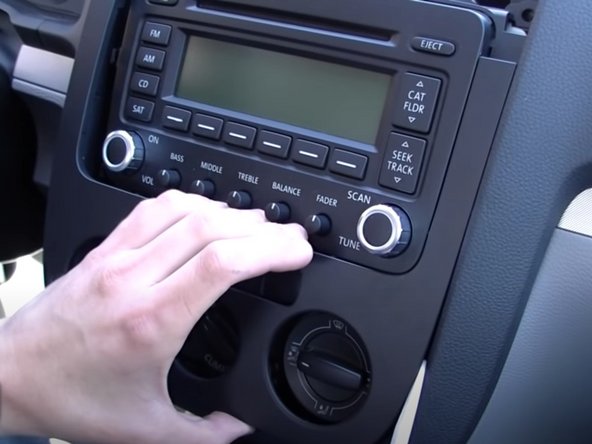

2008 Volkswagen Jetta Radio Replacement

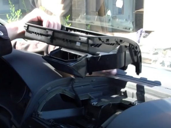

  4. 2008 Volkswagen Jetta Radio Replacement: crwdns2935265:04crwdnd2935265:01crwdnd2935265:03crwdne2935265:0 2008 Volkswagen Jetta Radio Replacement: crwdns2935265:04crwdnd2935265:02crwdnd2935265:03crwdne2935265:0 2008 Volkswagen Jetta Radio Replacement: crwdns2935265:04crwdnd2935265:03crwdnd2935265:03crwdne2935265:0
    • Use the panel tool and slowly loosen up the outer shell by following the crevice outline.
    • Once loosened up remove the upper face layer.
    • When removing this layer there will be a wire connecting the passenger air bag light. Leave that wire alone and carefully place the layer on the dashboard.

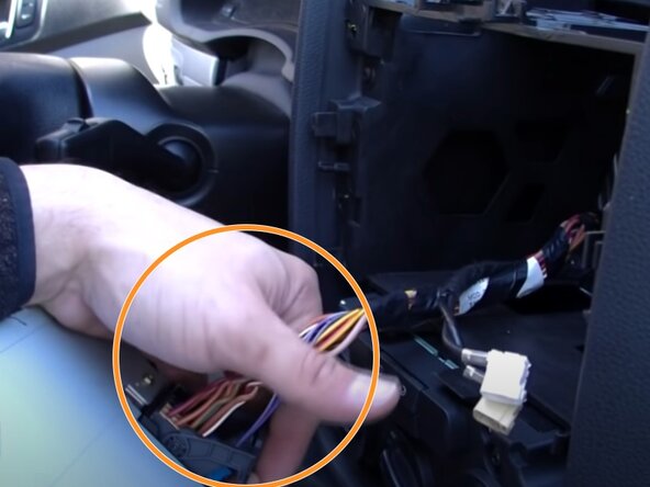

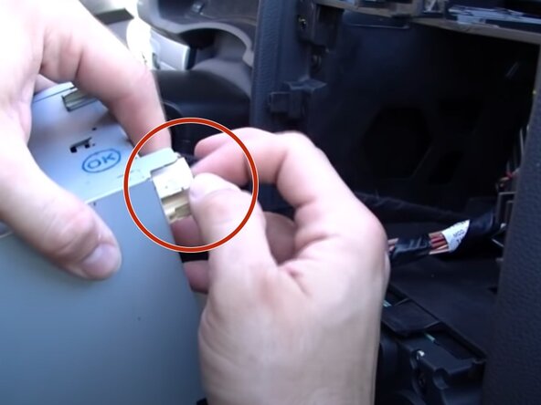

  7. 2008 Volkswagen Jetta Radio Replacement: crwdns2935265:07crwdnd2935265:01crwdnd2935265:03crwdne2935265:0 2008 Volkswagen Jetta Radio Replacement: crwdns2935265:07crwdnd2935265:02crwdnd2935265:03crwdne2935265:0 2008 Volkswagen Jetta Radio Replacement: crwdns2935265:07crwdnd2935265:03crwdnd2935265:03crwdne2935265:0
    • There will be two clipped wires on the back of he radio.
    • Push the clips in on the black wires connected to loosen them up and carefully pull out the wire.
    • The second bunch of wires will only require a flip of the lever down on the bottom of the black outer box. Once flipped up remove the whole box to free the radio.
