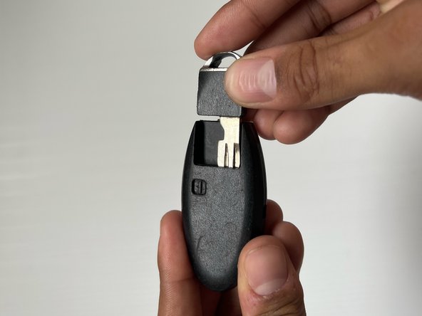

    • Press the release tab on the back of the key fob, and remove the metal car key.

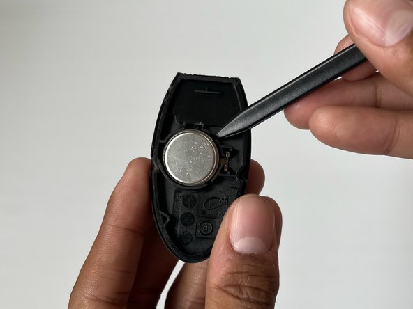

    • Use a spudger to pry the panel underneath the car key compartment open.
    • Open it carefully to avoid causing damage or scratches to the panel.

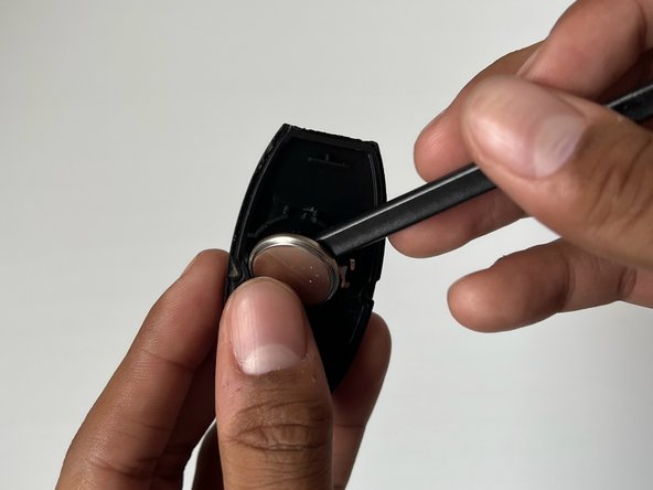

    • Use a spudger to remove the old battery from the socket.
