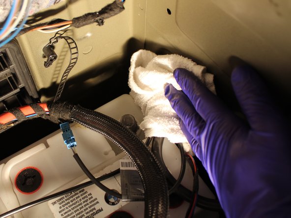

  2. 2008 BMW 335xi Blower Motor Replacement: crwdns2935265:02crwdnd2935265:01crwdnd2935265:02crwdne2935265:0 2008 BMW 335xi Blower Motor Replacement: crwdns2935265:02crwdnd2935265:02crwdnd2935265:02crwdne2935265:0
    • Remove the panel on the right side of the trunk to expose the battery.
    • Twist the knob to unlatch the door so that you can remove it.

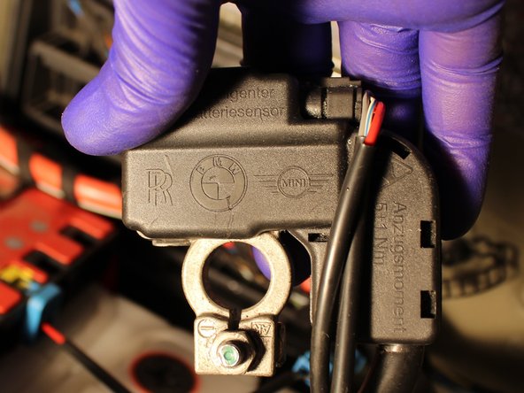

  3. 2008 BMW 335xi Blower Motor Replacement: crwdns2935265:03crwdnd2935265:01crwdnd2935265:03crwdne2935265:0 2008 BMW 335xi Blower Motor Replacement: crwdns2935265:03crwdnd2935265:02crwdnd2935265:03crwdne2935265:0 2008 BMW 335xi Blower Motor Replacement: crwdns2935265:03crwdnd2935265:03crwdnd2935265:03crwdne2935265:0
    • Use a 10mm socket wrench to loosen the bolt and remove the negative battery terminal.
    • Then tuck it to the right side and wrap it in a rag.
    • This prevents the circuit from being accidentally completed while you continue working.

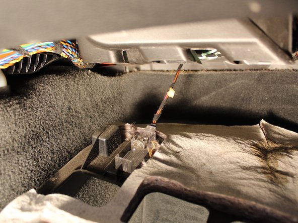

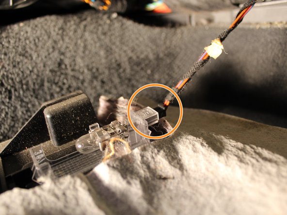

  4. 2008 BMW 335xi Blower Motor Replacement: crwdns2935265:04crwdnd2935265:01crwdnd2935265:03crwdne2935265:0 2008 BMW 335xi Blower Motor Replacement: crwdns2935265:04crwdnd2935265:02crwdnd2935265:03crwdne2935265:0 2008 BMW 335xi Blower Motor Replacement: crwdns2935265:04crwdnd2935265:03crwdnd2935265:03crwdne2935265:0
    • Remove the two T20 Torx screws located below the glove box.
    • One is located all the way on the right and the other one is located all the way on the left.
    • The panel will drop down as the screws are removed. Pull the panel away slightly.
    • Careful not to let it drop all the way down as a wire is connected to the footwell light.
    • Disconnect the black cable for the footwell light.

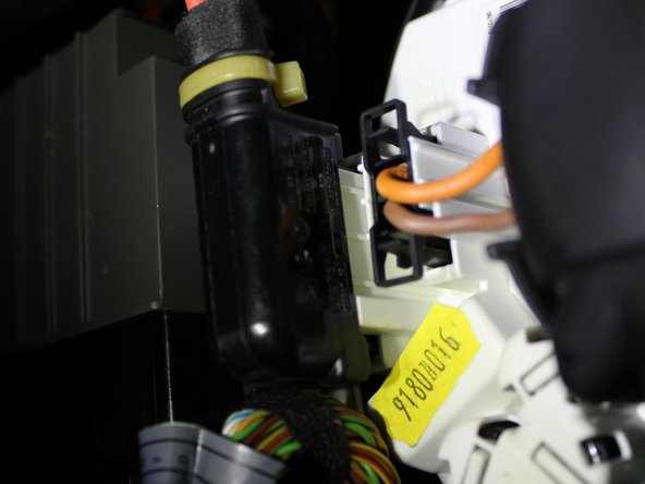

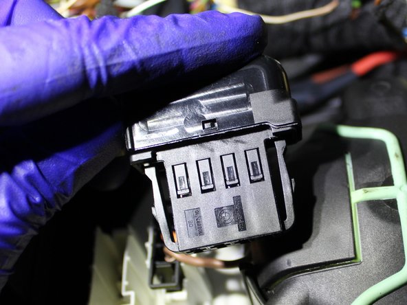

  5. 2008 BMW 335xi Blower Motor Replacement: crwdns2935265:05crwdnd2935265:01crwdnd2935265:03crwdne2935265:0 2008 BMW 335xi Blower Motor Replacement: crwdns2935265:05crwdnd2935265:02crwdnd2935265:03crwdne2935265:0 2008 BMW 335xi Blower Motor Replacement: crwdns2935265:05crwdnd2935265:03crwdnd2935265:03crwdne2935265:0
    • There is only one connecter that needs to be disconnected to remove the blower motor. This connector is black with two red/orange wires going into it.
    • Pinch the connector on the top and bottom and pull it out to remove it.

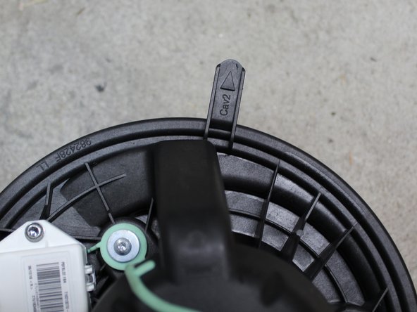

  6. 2008 BMW 335xi Blower Motor Replacement: crwdns2935265:06crwdnd2935265:01crwdnd2935265:02crwdne2935265:0 2008 BMW 335xi Blower Motor Replacement: crwdns2935265:06crwdnd2935265:02crwdnd2935265:02crwdne2935265:0
    • Pull down on the tab towards the front of the car and at the same time turn the whole assembly clockwise.
    • Pull the round black assembly out from the vehicle.
    • This is the blower motor assembly!
    • When pulling the blower motor out, be careful not to drop it on yourself.
To reassemble your blower motor, follow these instructions in reverse order.
