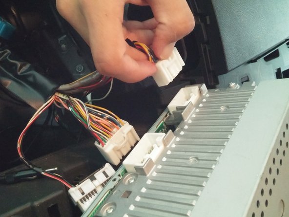

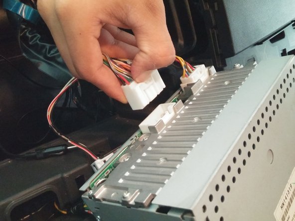

  13. 2008-2010 Mitsubishi Lancer Radio/CD Player Replacement: crwdns2935265:013crwdnd2935265:01crwdnd2935265:03crwdne2935265:0 2008-2010 Mitsubishi Lancer Radio/CD Player Replacement: crwdns2935265:013crwdnd2935265:02crwdnd2935265:03crwdne2935265:0 2008-2010 Mitsubishi Lancer Radio/CD Player Replacement: crwdns2935265:013crwdnd2935265:03crwdnd2935265:03crwdne2935265:0
    • Remove both the large and small wire harnesses by firmly pressing in and holding the retaining clip.
    • While continuing to hold down the retaining clip, firmly pull the harnesses out.
    • Do not pull harnesses out by the wires, as you may damage or break the wires. Instead pull out by the white plastic harness.
