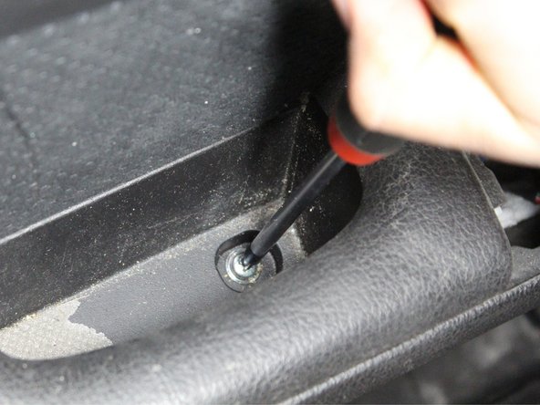

  4. 2007 Mazda 6 Door Speaker Replacement: crwdns2935265:04crwdnd2935265:01crwdnd2935265:02crwdne2935265:0 2007 Mazda 6 Door Speaker Replacement: crwdns2935265:04crwdnd2935265:02crwdnd2935265:02crwdne2935265:0
    • Peel off the rubber insert in the inner arm rest.
    • The insert should be glued down if this is the first time you are disassembling the door.
    • Unscrew the inner arm rest panel with the phillips screwdriver. This screw is holding the arm rest panel together.
    • On the passenger side the screw will be inside the upright handle. Pry off the handle cover and unscrew the screw hidden inside.

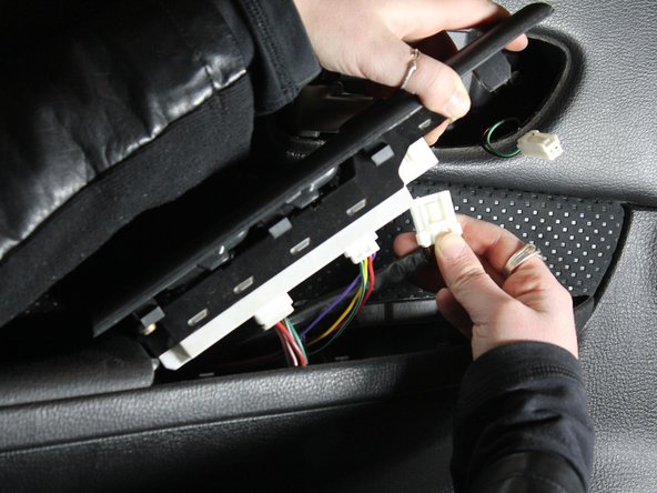

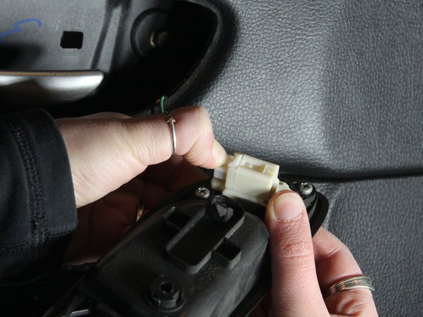

    • Pry the power window switch case out of the arm rest with your flathead screwdriver.
    • Detach all tabs on the back of the switch case to remove completely.

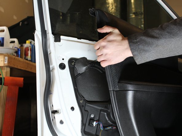

  7. 2007 Mazda 6 Door Speaker Replacement: crwdns2935265:07crwdnd2935265:01crwdnd2935265:02crwdne2935265:0 2007 Mazda 6 Door Speaker Replacement: crwdns2935265:07crwdnd2935265:02crwdnd2935265:02crwdne2935265:0

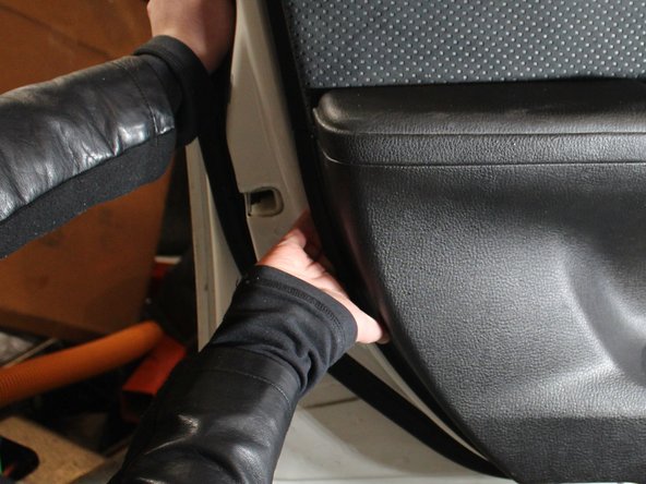

    • Pop out the door panel starting on the side closest to the door hinges.
    • You will have to tug it roughly to detach the tabs holding the panel in place.

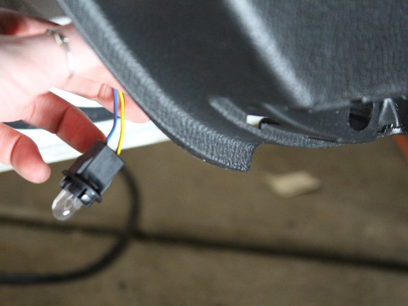

  8. 2007 Mazda 6 Door Speaker Replacement: crwdns2935265:08crwdnd2935265:01crwdnd2935265:03crwdne2935265:0 2007 Mazda 6 Door Speaker Replacement: crwdns2935265:08crwdnd2935265:02crwdnd2935265:03crwdne2935265:0 2007 Mazda 6 Door Speaker Replacement: crwdns2935265:08crwdnd2935265:03crwdnd2935265:03crwdne2935265:0

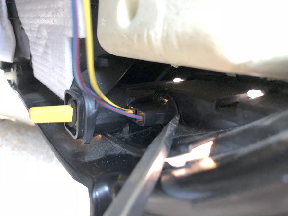

    • (OPTIONAL) Pop off the light cover.
    • Use a flathead screwdriver to press the clip holding the light from the back of the door and pull the lightbulb out.

    • Lift the door panel up and out to remove.

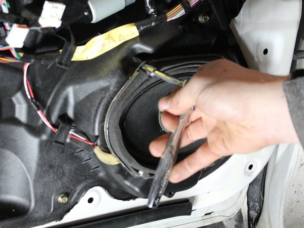

  10. 2007 Mazda 6 Door Speaker Replacement: crwdns2935265:010crwdnd2935265:01crwdnd2935265:03crwdne2935265:0 2007 Mazda 6 Door Speaker Replacement: crwdns2935265:010crwdnd2935265:02crwdnd2935265:03crwdne2935265:0 2007 Mazda 6 Door Speaker Replacement: crwdns2935265:010crwdnd2935265:03crwdnd2935265:03crwdne2935265:0

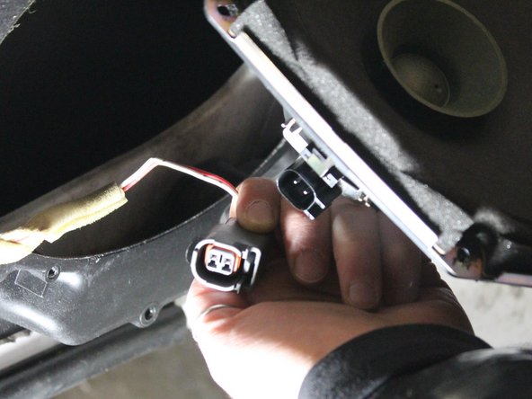

    • Unscrew four bolts holding the speaker with the ratchet.
    • Pull out the speaker.
    • Detach the connector in the back.

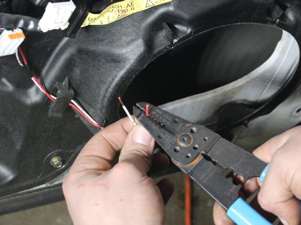

  11. 2007 Mazda 6 Door Speaker Replacement: crwdns2935265:011crwdnd2935265:01crwdnd2935265:02crwdne2935265:0 2007 Mazda 6 Door Speaker Replacement: crwdns2935265:011crwdnd2935265:02crwdnd2935265:02crwdne2935265:0

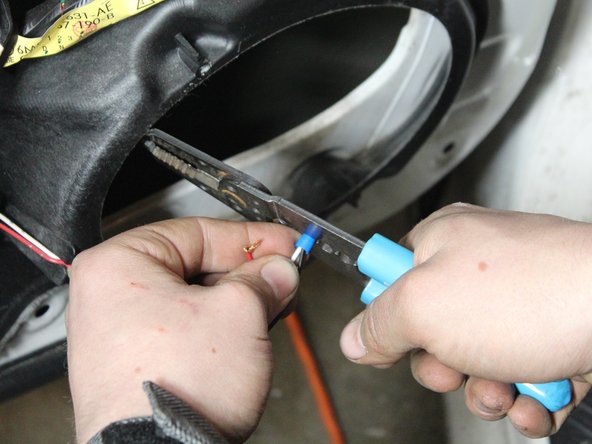

    • Cut and strip the wires that were connected to the speaker.

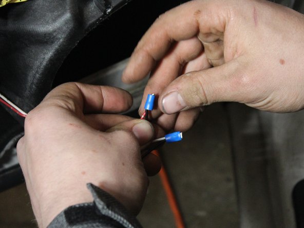

  12. 2007 Mazda 6 Door Speaker Replacement: crwdns2935265:012crwdnd2935265:01crwdnd2935265:03crwdne2935265:0 2007 Mazda 6 Door Speaker Replacement: crwdns2935265:012crwdnd2935265:02crwdnd2935265:03crwdne2935265:0 2007 Mazda 6 Door Speaker Replacement: crwdns2935265:012crwdnd2935265:03crwdnd2935265:03crwdne2935265:0
    • Check the speaker connectors to determine which one connects to the positive and negative terminals. The speaker should have a + sign next to the positive terminal.
    • Splice the wires from the door to the new speaker's wires making sure to connect the correct wire polarity. (The small connector wire from the speaker is positive.)
    • In the driver side door, the positive wire is red and the negative wire is white.
    • In the passenger side door, the positive wire is blue and the negative wire is yellow.
    • Cover and crimp the wires with the butt-end connectors.
