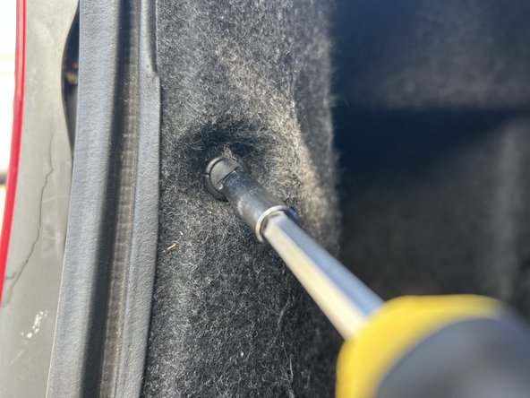

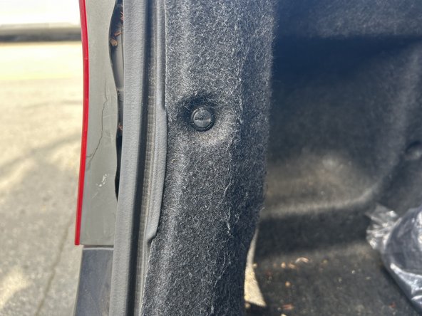

  2. 2007 Honda Civic Reverse Lights Replacement: crwdns2935265:02crwdnd2935265:01crwdnd2935265:02crwdne2935265:0 2007 Honda Civic Reverse Lights Replacement: crwdns2935265:02crwdnd2935265:02crwdnd2935265:02crwdne2935265:0
    • Insert a flathead screwdriver into the fastener.
    • Rotate the screwdriver counterclockwise until the fastener loosens.
    • Carefully remove the fastener.

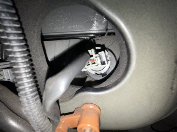

  3. 2007 Honda Civic Reverse Lights Replacement: crwdns2935265:03crwdnd2935265:01crwdnd2935265:02crwdne2935265:0 2007 Honda Civic Reverse Lights Replacement: crwdns2935265:03crwdnd2935265:02crwdnd2935265:02crwdne2935265:0
    • Pull the lining away from the lights.
    • Carefully grasp the reverse light socket.
    • Make sure it is the correct socket; do not remove the other sockets, as those are your brake lights and turn signal lights.
    • Twist left to release the socket.
    • Slowly pull back from the socket to have access to the light socket.

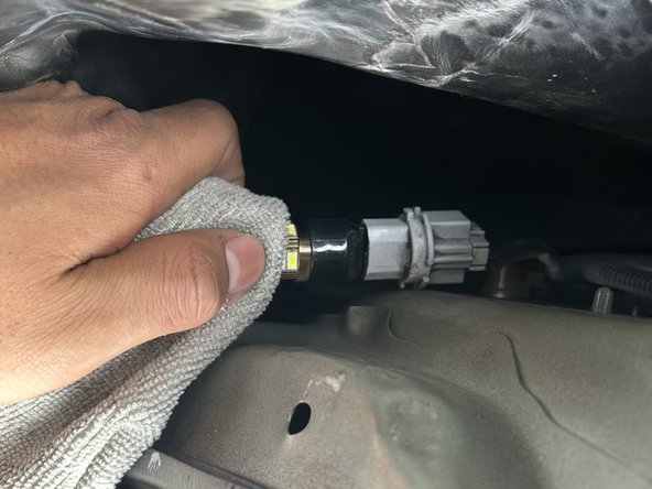

  4. 2007 Honda Civic Reverse Lights Replacement: crwdns2935265:04crwdnd2935265:01crwdnd2935265:03crwdne2935265:0 2007 Honda Civic Reverse Lights Replacement: crwdns2935265:04crwdnd2935265:02crwdnd2935265:03crwdne2935265:0 2007 Honda Civic Reverse Lights Replacement: crwdns2935265:04crwdnd2935265:03crwdnd2935265:03crwdne2935265:0
    • Use a paper towel or rag to pull the socket back carefully and remove the light.
    • Do this for both sides when replacing the reverse lights.

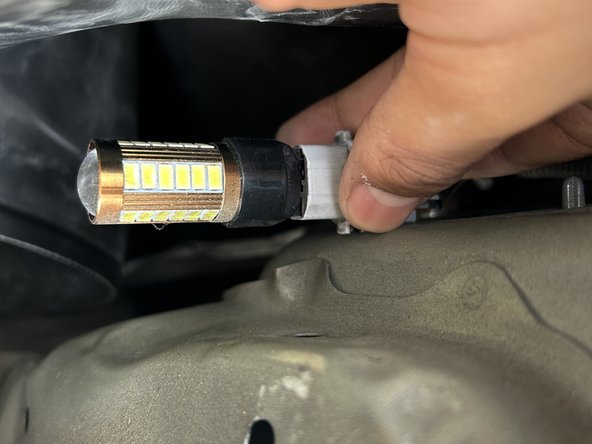

  5. 2007 Honda Civic Reverse Lights Replacement: crwdns2935265:05crwdnd2935265:01crwdnd2935265:01crwdne2935265:0
    • Get your new reverse lights and install into each socket.
    • When installing, instead of pulling, push into the sockets and ensure they are locked in place.
  6. 2007 Honda Civic Reverse Lights Replacement: crwdns2935265:06crwdnd2935265:01crwdnd2935265:01crwdne2935265:0
    • Twist to the right and ensure it is locked into place.
