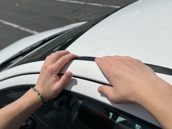

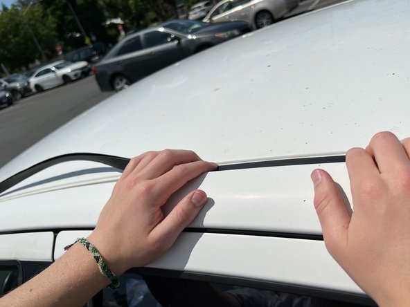

    • Peel back the old molding from where it is beginning to come off until you reach the end of the rail.

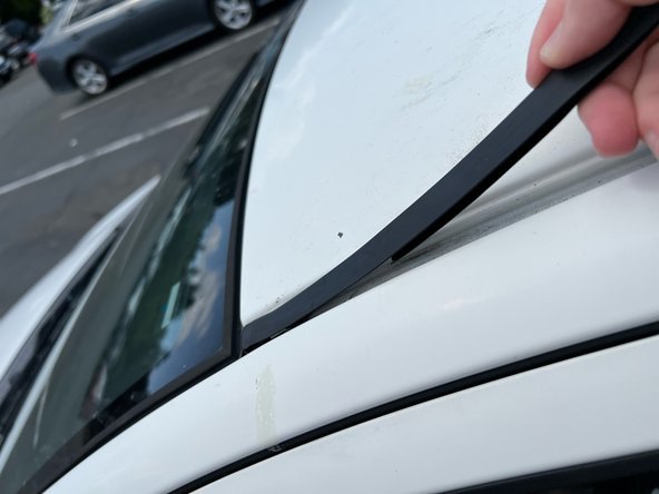

    Heavy-Duty Spudger
    • Use a heavy duty spudger to disconnect the end of the drip rail.
    • It may be connected at the end pretty tightly so it could take some work to remove.
    • Completely remove the piece from the end.

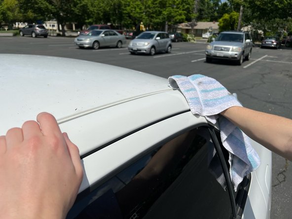

    • Take a rag and clean out any dirt and debris that built up under the old molding.

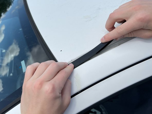

    • Slide the end of the new piece into the designated spot and press firmly to ensure it's connected securely.
    • Lightly tug at it to make it is secure and won't come off.
    • Do the same to the opposite end of the drip rail.
    • The molding for the left and right drip rails are different parts.

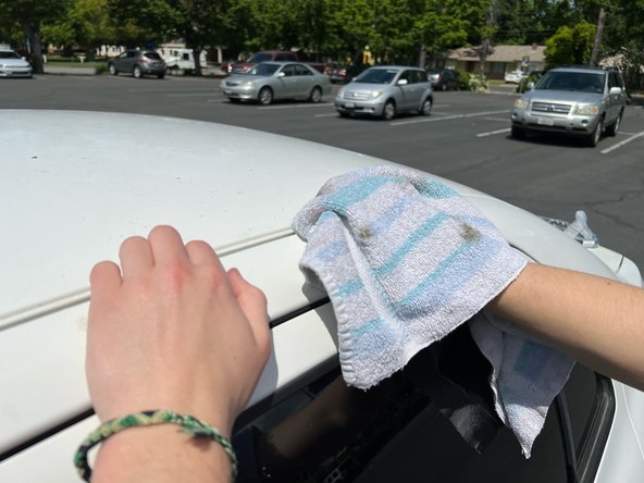

  5. 2007-2011 Toyota Yaris Drip Rail Replacement: crwdns2935265:05crwdnd2935265:01crwdnd2935265:03crwdne2935265:0 2007-2011 Toyota Yaris Drip Rail Replacement: crwdns2935265:05crwdnd2935265:02crwdnd2935265:03crwdne2935265:0 2007-2011 Toyota Yaris Drip Rail Replacement: crwdns2935265:05crwdnd2935265:03crwdnd2935265:03crwdne2935265:0
    • Firmly press the drip rail into its place starting at one end and moving down the car.
    • Check to make sure the new drip rail is thoroughly sealed to the car.
