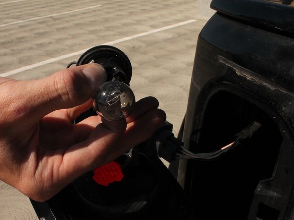

    • Twist the back of the light bulb counterclockwise until it loosens.
    • Twist and pull carefully until the light bulb and socket are removed together.

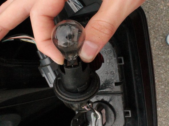

  6. 2007-2012 Jeep Wrangler Tail Light Bulb Replacement: crwdns2935265:06crwdnd2935265:01crwdnd2935265:02crwdne2935265:0 2007-2012 Jeep Wrangler Tail Light Bulb Replacement: crwdns2935265:06crwdnd2935265:02crwdnd2935265:02crwdne2935265:0
    • Pinch the clips just below the light bulb. These hold the light bulb in place.
    • Pull until the light bulb is released from the socket.
    • If the light bulb is faulty, dispose of it properly.

I got that far but I cant get the bulbs out - they seem to be stuck in the sockets - any ideas? thank you very much - steven
steven - crwdns2934203:0crwdne2934203:0
On mine the clips actually need to be pushed out and not pinched - can stick a small screwdriver in there to push them out ( maybe one for each)
Maurice D. Alexander -
Try spraying some WD40 where the bulb plugs into the socket. Let it sit a few minutes, then try pilling the bulb out.
